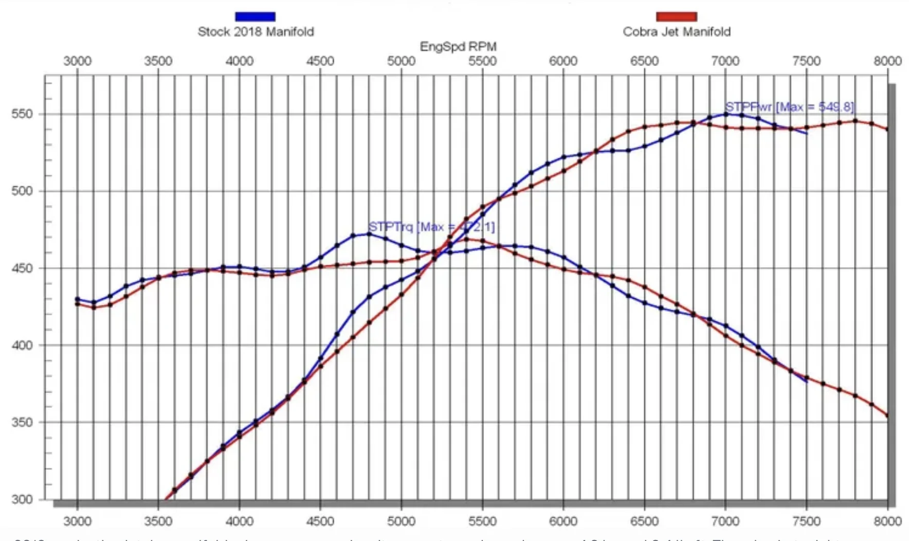

Had you considered the Cobrajet at all or is the cost of switching over too much for the gain?
The Boss 302 is at least cheap enough where you could try it and if it didn't work better than the 2018 you could always easily re-sell it for what you paid for it.
I’ve got room to pulley down one more time, I’ll try that first and see if I can keep my 60’, and get a lil better up top. If it doesn’t I’ll try the boss. The cobra jet is phenominal for NA, I’ve never considered it with boost. I think I would follow your advice first with the boss.
