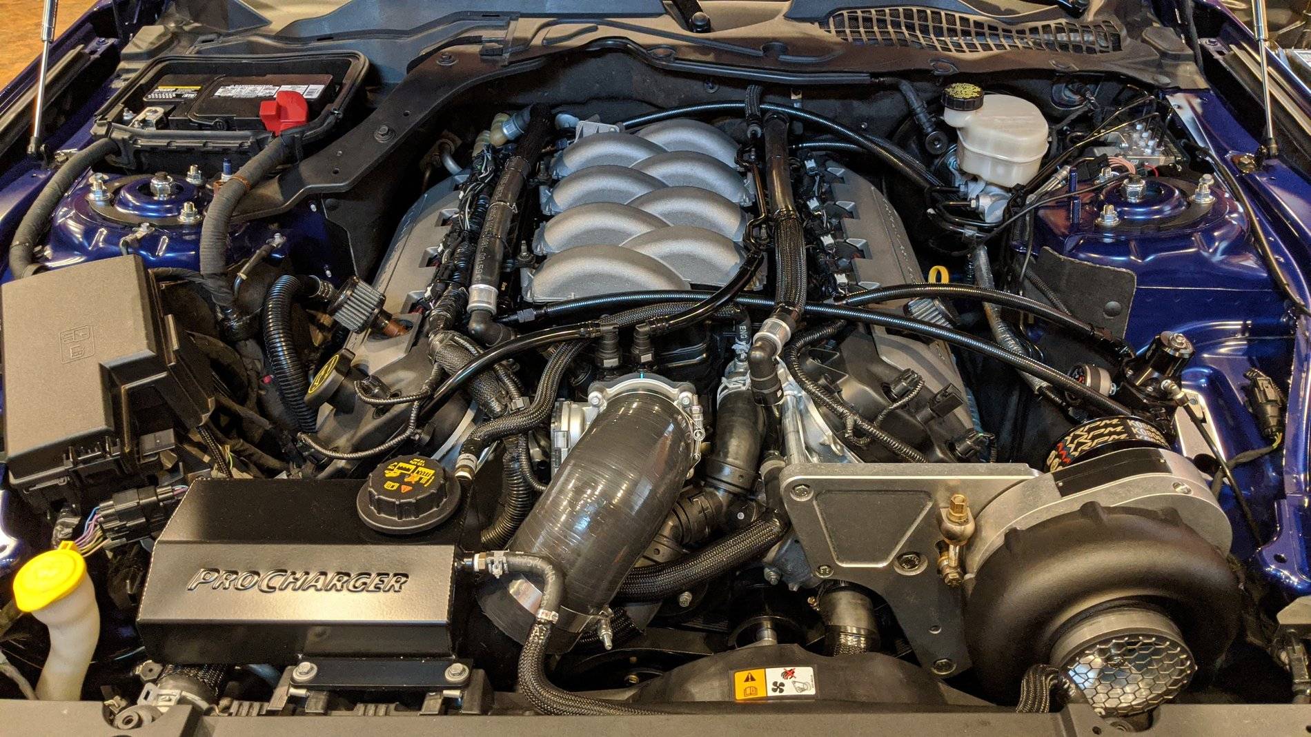

anyone know how difficult it is to custom paint the basic satin blower finish to another color of choice? i know PC offers black and polished, but wondering if certain local shops could hand paint the head and bracket units? i assume the blower itself couldnt be powder coated unless taken apart to some degree?

I would look into places that do ceramic coatings for exhausts. The place that did m ceramic coating on my kooks headers will paint pretty much anything. Was thinking about seeing how much it would cost to get my procharger painted black since i ordered it in satin way back in the day and black wasnt an option.
Of course the volute and bracket can be painted. The transmission section can be painted by removing pulley, but quality will be marginal if not disassembled. Two toned isn't bad...
