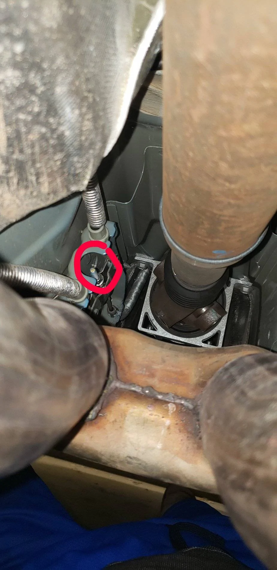

So I found a thread in here that showed me the location of the adjustment for the e-brake cable above the resonator. So I got my car up on a lift to look and it appears I can't get to it unless I removed resonator. Just wondering if anybody has an idea of how to do this without removing the resonator?

No need to remove anything. I believe I used a 10mm wrench and was able to adjust it.

Come in from the back and use every extension you have and a swivel adapter if you have it. The nut should be on the left side facing rearward.
The first time I did it I just used the extensions and twisted by hand.

I took the plunge and tightened mine up today. I'm not quite flat enough to get where I needed to be under the car, but my ramps proved to give plenty of clearance. That was good advice to use all available extensions - it was probably flexy enough to do the job as is, but I added a swivel just to be safe. Mine took a lot more turns than I was expecting, but in the end I have a handle with no play any more. Holds well on my hill without the emergency brake creaking now, which was the goal. :-)

I have too much play in the cable and the handle comes up so easily that even on the highway a little bump with my knee and my cruise control turns off.

Okay guys, I guess I wasn't very bright cuz I looked at it from the side and didn't think about trying to look at it from behind to see if I could get to it. I'll throw it back up on my buddies lift next week and try it again.

Dude, if you have it up on a lift - you'll be done in 5 minutes. Easy peasy.
