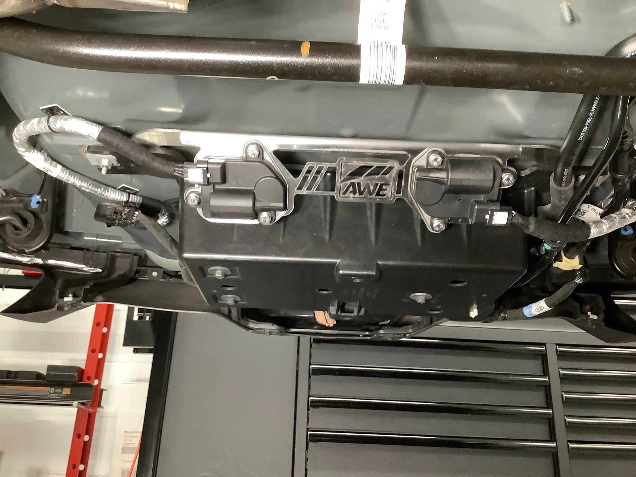

U can also go the route of installing the AWE exhaust bracket. Just my 2 cents

^^This^^. This way you’ll retain drive modes and don’t have to pull any fuses. That’s the route I took when I installed my Steeda axle back exhaust.
1. Yes you will get a check engine light eventually and the codes will be related to the active exhaust.
2. Don’t pull the fuses.
It will cause you issues with the sensors for the cats as well as the differential pressure sensor.
solution…..
1. you can buy dongles that plug in and eliminate the check engine light. BMW ones will actually work on s550 mustangs.
2. best solution.
Leave the actuators plugged in. You can either strap them under the bumper or buy the awe bracket and they will continue to work.
