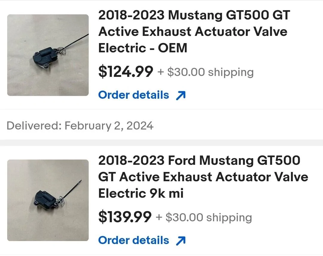

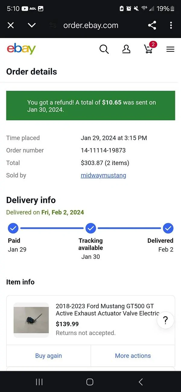

Yes. That's the way. I purchased two actuators off ebay for about 150ea or so. The pig tails were really cheap from local Ford dealership, like less than $20ea cheap. It was for a GT500 but basically all the same. You should be able to replace all this stuff for about $300 worst case,maybe better. GL

Midway Mustang on ebay. They worked as described....
