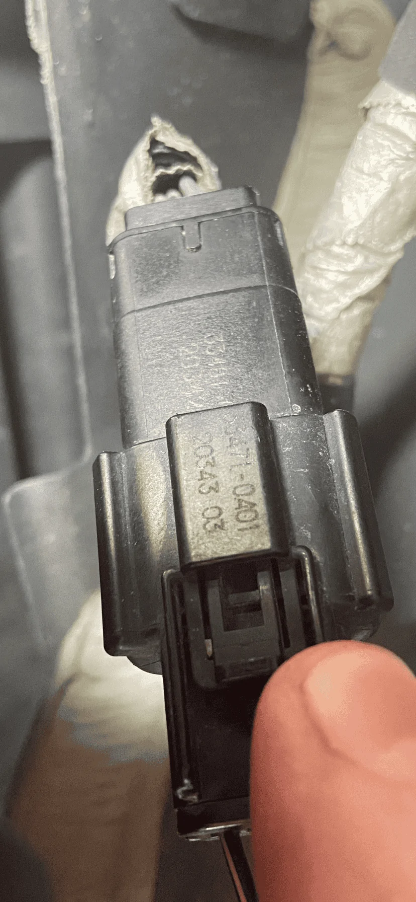

‘21 GT, how do you disconnect the active exhaust pigtail?
Alot of times they get stuck for some odd reason, what has worked for me is press it back in then try and pull them apart while pressing the tab

2019 Ruby Red GT-350 # K1989
The ones on my 19 Shelby you have to take a small screwdriver and pull back on the small tab in the part that you are attempting to push down, it's like some kind of a lock or something.
A real PITA as you don't have a lot of room to work...Good Luck.

21 Mach 1. FJG, Tremec, ESS G3X
I agree on the push together, then squeeze the tab and pull apart. They can get stuck over time.

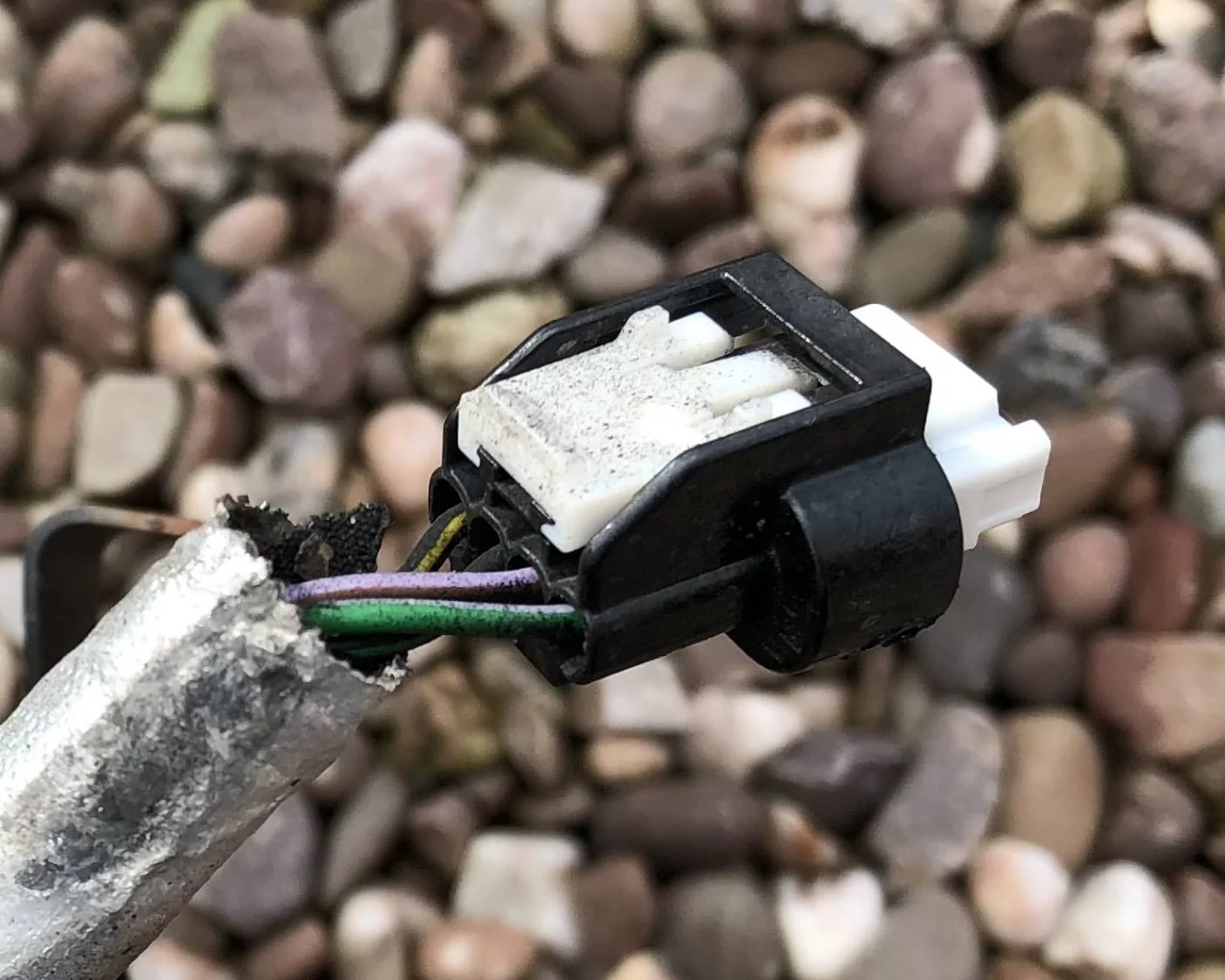

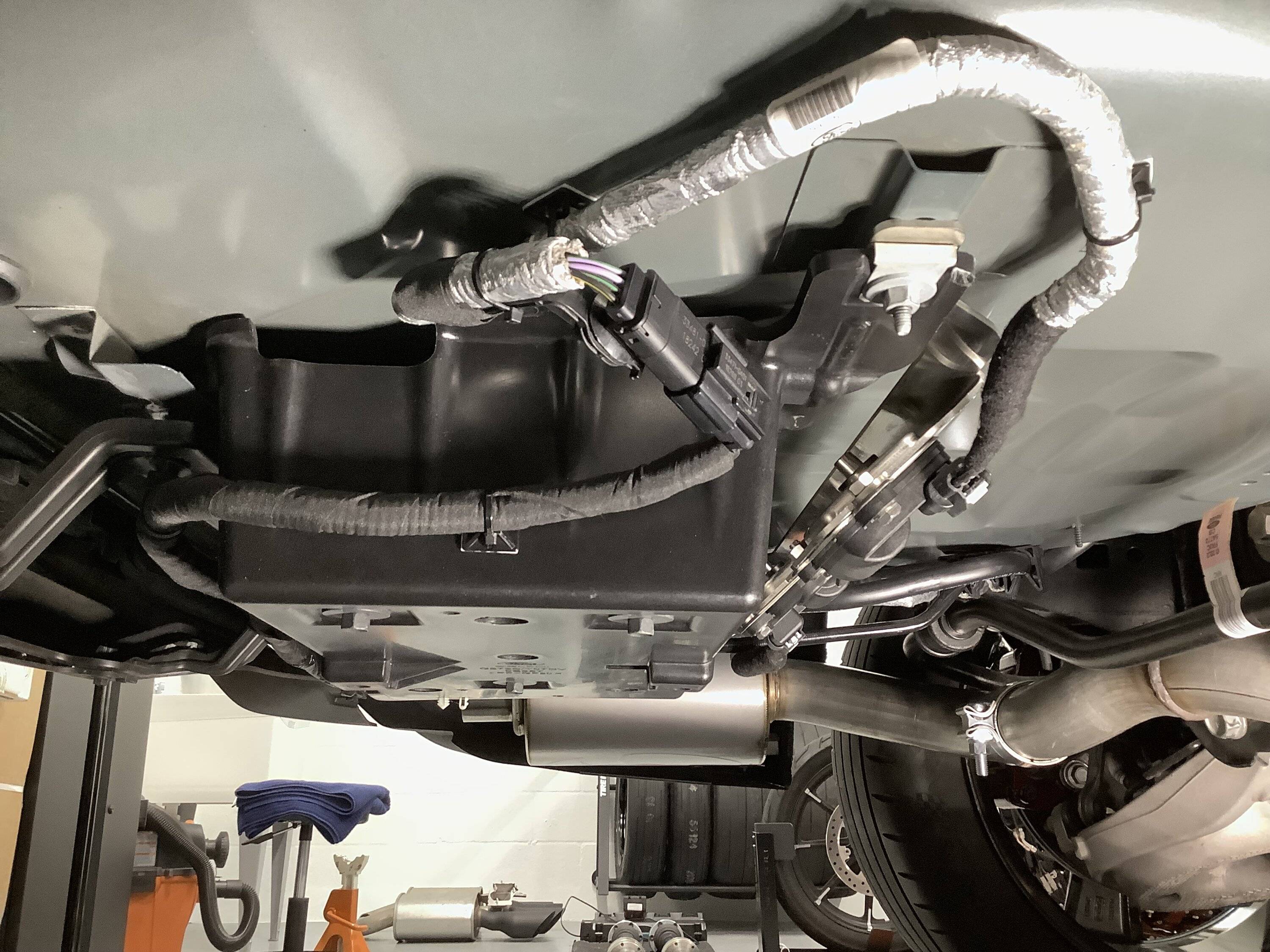

I thought I read a post on this thread yesterday about a white clip ?
Anyhow, I found a photo of mine and it’s different than yours (and it has the white clip) ?
Unless you photo is the pigtail to car end ?
WD :like:
hey WD, that was me, who posted yesterday about the white locking clip. At first glance, I thought it was the actuator connector, but quickly realized it was the pigtail to car end, so I deleted my post.
