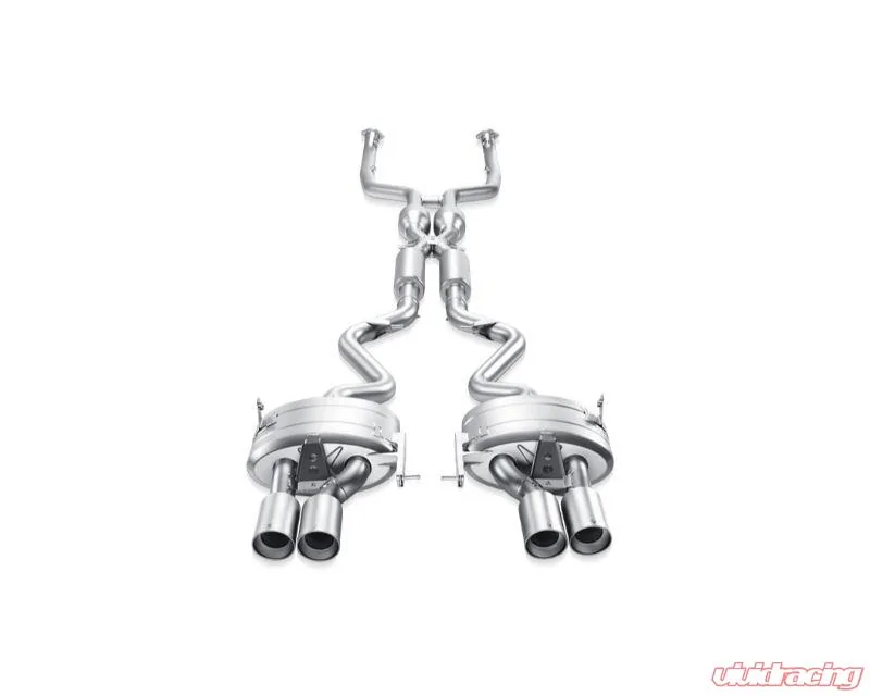

Didnt the Akropovic for the E92 M3 do this.

Haha :p
I meannnnn, If it improves the sound quality of my exhaust note I'm all for it.
Akrapovic who makes exhausts for exotics and such makes an exhaust for the E92 M3 and it had both an h and x built into their midpipe. So its been done before.
