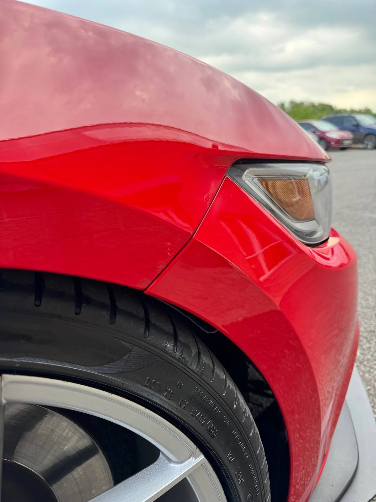

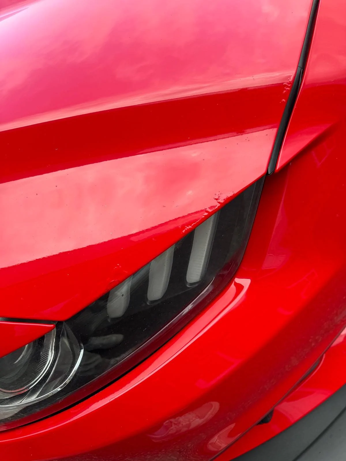

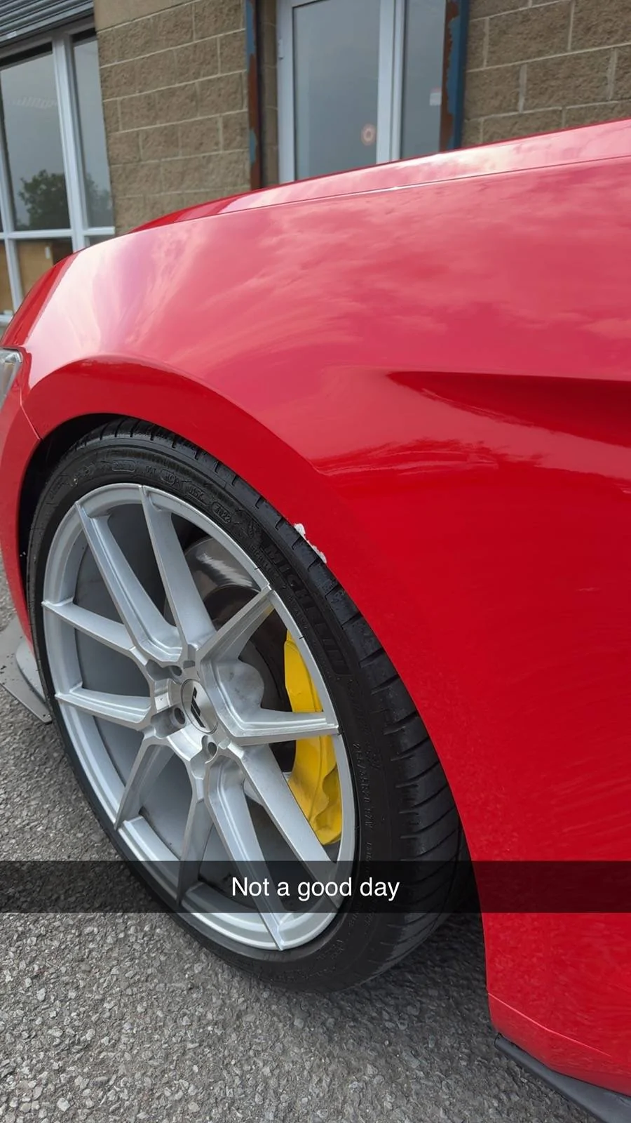

2. I have started noticing bubbling on my bonnet & wing, notified the local ford dealership and they said they would look into the TSB(this is at least a month ago and still no update)
The car is not in warranty anymore so I’m guessing they wont cover it but definitely worth trying more.
Just wondering if anyone has any ideas or has encountered these issuebefore.

Both are known issues. I agree with one of the other posters, haven’t seen much with paint issues on the fenders. It’s most common on the hood (bonnet). The threads posted are good ones to check out but you’re likely on your own since you’re out of warranty. The AC would be covered if you have an extended warranty, the paint would not if I recall the language in mine correctly.
