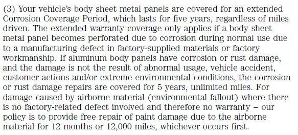

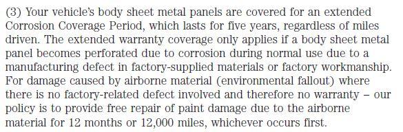

Note the difference in the warranty language between 2015 and 2016+. For the 2015 warranty to be given, the body panel must be perforated (ie, a hole all the way through the panel).
But in 2016 they addressed aluminum panels specifically, and didn't say it had to be perforated, just corroded to be covered under the corrosion warranty. Huge difference between the 2015 warranty language and the 2016+ warranty language concerning aluminum body panels.
Everyone with a 2015 should be calling Ford and complaining that they didn't also include the 2015 model year in their revised corrosion warranty for aluminum panels.
2015 Corrosion Warranty Statement
2016+ Corrosion Warranty Statement
