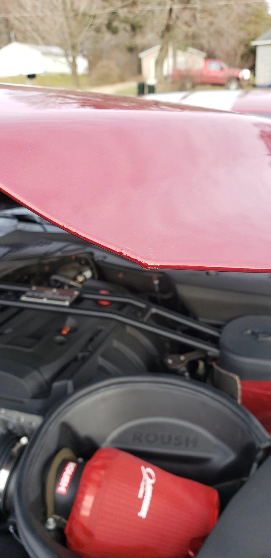

Hood Bubbling paint
bossgt1982
Jun 17, 2018
illinois
2016 Ecoboost.1982 mustang gt
Noticed Bubbling paint and corrosion on hood coming from underneath. Went to the Ford dealer and they took a bunch of pictures and sent to Ford. They approved replacement of the hood. Anyone else with this problem?
