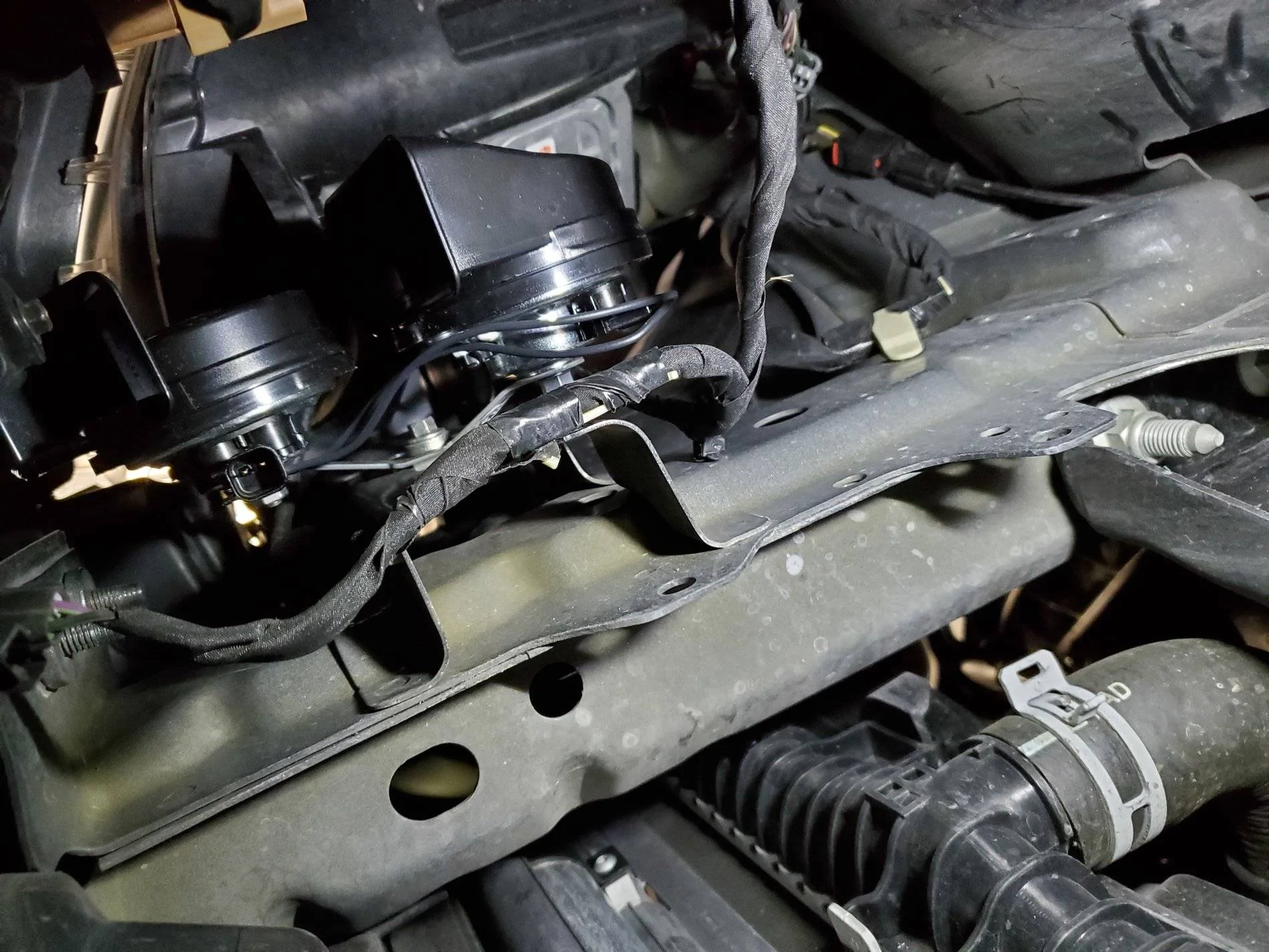

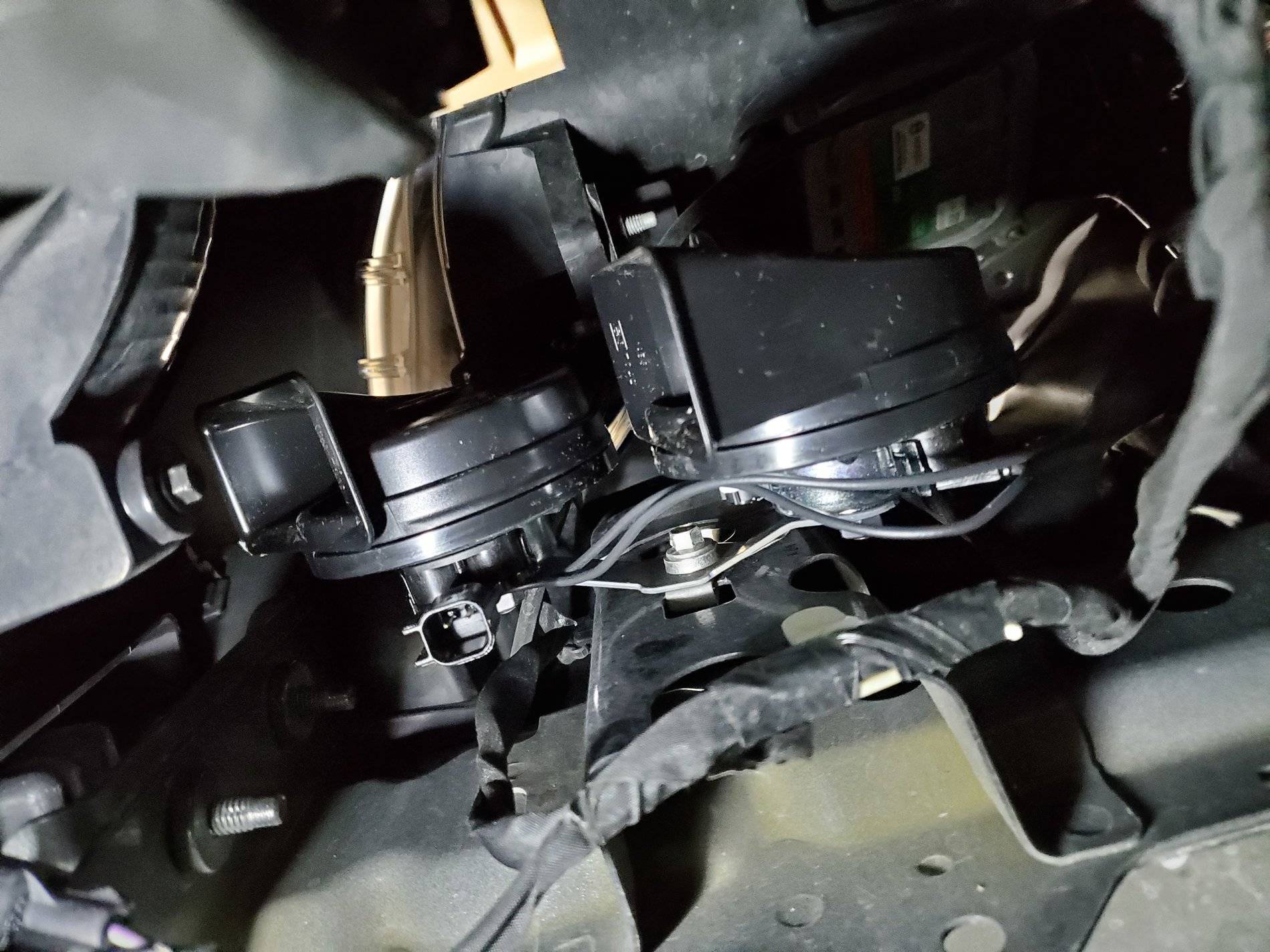

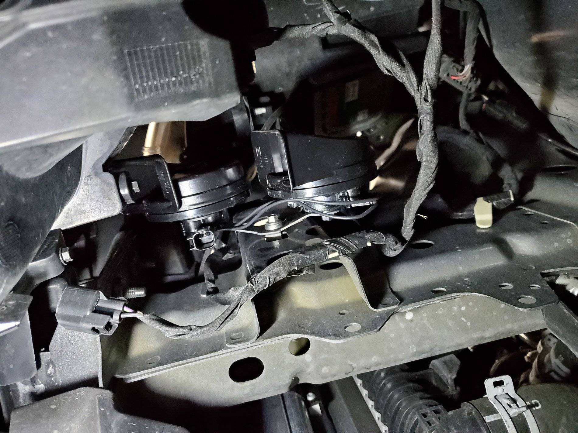

if you determine that the horn does need replacement, I found the best way to getting to it, on my '15 GT, is by removing the splash guard, the horn is on the drivers side in the engine bay. There is plenty of room to reach the one support nut with a socket wrench. Recommend you remove the electrical connection first, horn removal is easy.
I got my Ford factory p/n Product SKU: FR3Z-13832-G from https://autopartscheaper.com/ for $20.92. It's sounds great again.
