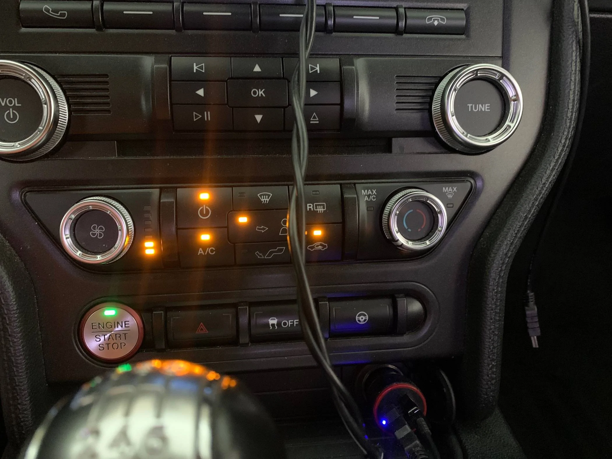

These are literally my hvac settings while racing on a hot day. Forcing the main cooling fan on with A/C is way more effective than the hvac fan.
Huh, I guess under those conditions that makes sense. I’ve just never heard of using the A/C to promote cooling and hp gains.
Wouldn’t the effort on track raise coolant temps high enough to force the fan to run at max capacity as well?
I’m not being nitpicky, I’m actually learning a thing or two about this car.
The fans on would cool better if the condenser wasn't being used. It gets hot so the fans are pulling hotter air than ambient.
The cooler cabin is nice but I'd have my tuner turn the fans on 100% at 180 degrees coolant temp or lower.
the fan on temp thresholds are REALLY high from the factory. The A/C “trick” just delays the time until the car gets there. And increases the chances that your run starts with the coolest coolant possible.
This is true, stock programming means no fan until 217 cht or thereabouts. AC runs the low speed all the time. If your car has grille shutters the behavior is even more annoying.
