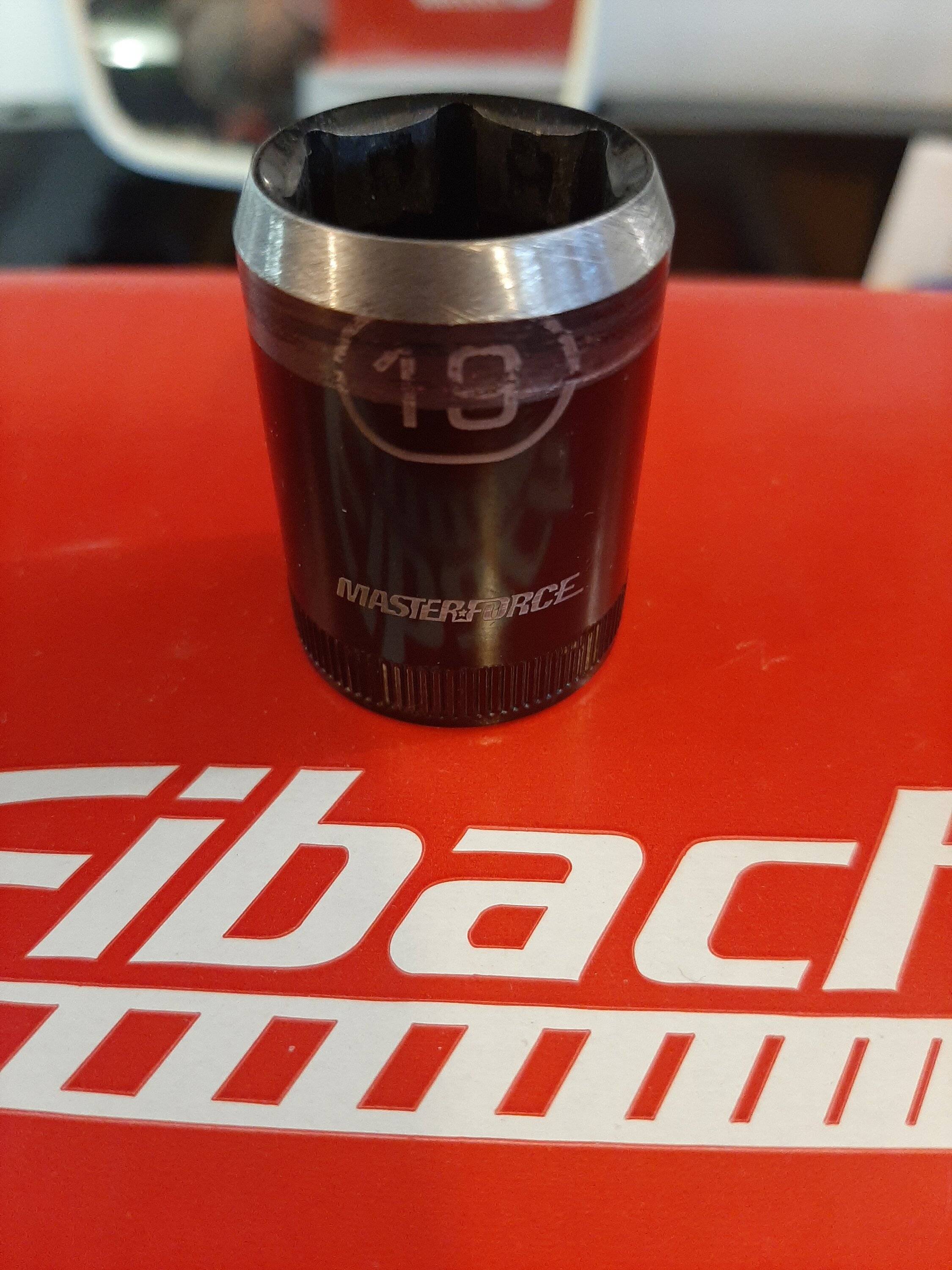

I agree with EFI. To have a better selection of drag radials, I run 19" GT350 (19x11) wheels on the back of my '20 GT500. The wheel offset difference is 12mm, so I use 20mm Eibach bolt-on spacers.
Torque spec for the 500 is 150 ft/lb, so that's what I use on the spacer bolts. To get a better grip on the spacer nuts in the spacer recess, I ground a 19mm inpact socket conical on the outside edge. I have run this setup for a year with no problem.

What i have been unable to understand is what you do with 19mm impact socket, we have a language barrier here, obviously my fault, sorry.

Photo of socket. The tapered recess in the spacer allows a standard socket to only contact about half of the lug nut. To fully engage the nut and spread the force of 150 ft/lb over a larger surface, the socket needs to be beveled to fit deeper into the recess.
Understood!
