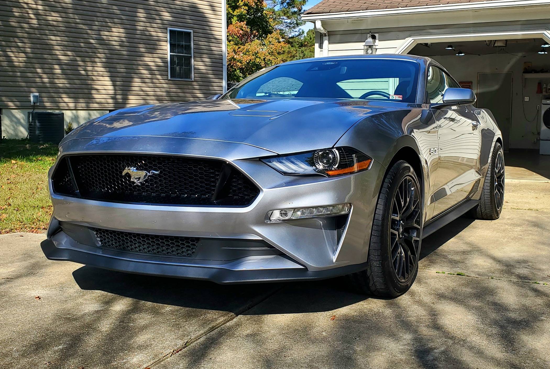

I've run the Steeda 25mm / 1" hubcentric spacers for a while now with no issue. For me, they are a temporary solution until I get aftermarket wheels with a better offset.
You can see how they sit. Granted I have the stock PP1 wheels that are 19x9 +45 in the front and 19x9.5 +52.5 in the back.
