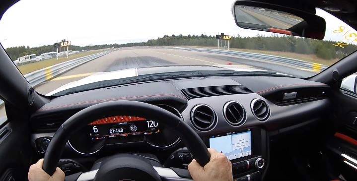

My 2018 A10 revs to 73- 7400 in 6th.....same as the other gears. In this picture, I am at 7000 in 6th. I doesn't shift to 7th until 127 mph.

Irony is the 120mph. That's where mine shuts down. 120-121 I've had it wait until 123 once at the track and once on the dyno. What gears and tune are you running?
