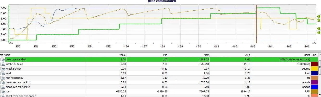

Here's what I datalogged from a 1/4mile pass, This was auto shifting in Sport mode .
7th gear was commanded at 6900, I lifted at 6880.
