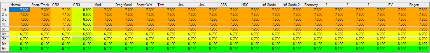

I believe the "WOT shift map" in the transmission programming has primary control for shifting at WOT. The FRPP tune does not change this map on a 2020 Mustang GT 10R80 with drive modes. Here's a snapshot of the table from the FRPP tune:

Thanks Doc. This is great info and very helpful. Appreciate that 👍.
