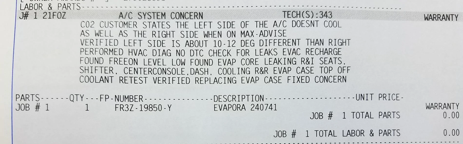

I noticed mine had the same issue while driving Thursday during lunch--- driver's side warm air, passenger side cool air when I had my A/C set to *maximum cool* in both zones. It's still hot here in Texas yet, so this was very easy to notice.
I took it to the dealer Friday morning and was the first one person in line waiting for them when they got in at 7am. I had mentioned to the dealer's service guy that I had read about the evaporators being a common problem with this symptom, but he seemed to think that it wouldn't cool at all if that was the case. (He turned out to be *wrong* because the evaporator was the cause of the freon leak!) In 30 minutes or so they had it diagnosed, I figured it might be all day or until Monday so I got a loaner.
To my surprise, at 11am they were done, and it was the same culprit as everyone else has had with their 2015's--- that faulty evaporator leaking.
I have the 2015 Mustang GT Premium, so the replacement part was the FR3Z*19850*Y part also. The dealer service guy said they have done a lot of these, and their techs have gotten really good at the replacement.
So far, my A/C now works again as it has before since I first turned it on.
I also attached a picture of MY repair form---I'm glad I paid for the full 7 years of warranty, also!
i think i got the latest and greatest? blows nice and cold again

so they were able to swap it out in 3 hrs? for the amount of work involved if they actually did it that quick thats impressive

They “fixed” it by putting in a recharge with sealant in it
DarkKnight
Nov 18, 2014
75
ATX
DIB 2015 Mustang GT
Believe what you want, but my dash was removed and put back because I can TELL it was removed-- they even removed the dust on it in the process!
