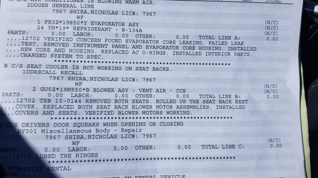

Well, we're back to ice cold again. Dropped the car off at 8am yesterday morning, was done by 11am today, so no complaints there.
Part number used this time is FR3Z-19850-V. Guess this is the same part that's been used for the past few months...

ugh, this is the #
FR3Z*19850*Y
and i didnt even know we could upload, so i fixed that too..thanks

ugh, this is the #
FR3Z*19850*Y
V - EB
W - V6
Y - GT
Yours is the latest for the GT. Both parts have been used for some time now, lets keep our fingers crossed that we don't become the first to experience failures with these parts :(
