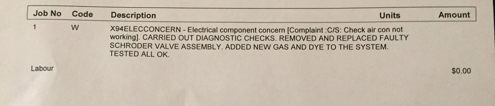

Took it in today.
Dealer called and said that they located a leaking valve in the aircon system which has been replaced and the system regassed.
Claims that the compressor isn't the issue on this occasion (but did admit that this is a known fault with the car).
Have since picked it up and can confirm that it's icy cold again and no longer making gargling noises or blowing white powder.
I'm a little skeptical, but hoping it lasts.
