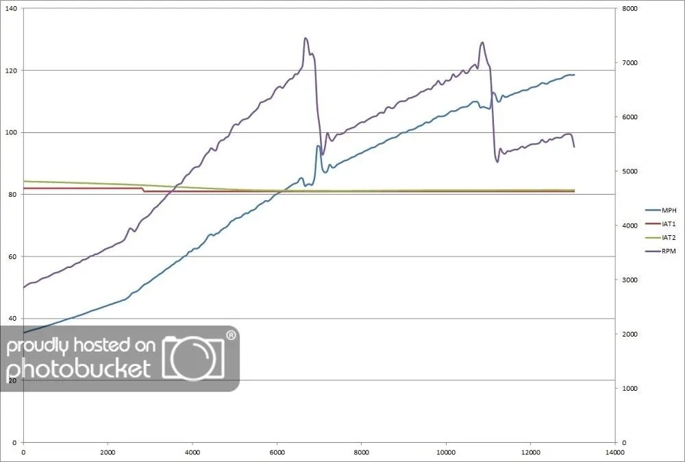

Car is almost perfectly tuned now thanks to Lund Racing. It is fast very fast but what will really blow some minds is how cool the intake air temperatures run. I mean the real inside the intake manifold temperature not the air temperature in the front of the throttle body. After running for over an hour and doing data logs including multiple full throttle runs the intercooler water was cold you could stick your finger in the tank and the water was cool. The intake manifold was cooler than the SC. We are talking 13 to 16 degrees above ambient in both traffic and under full boost of 10 pounds.

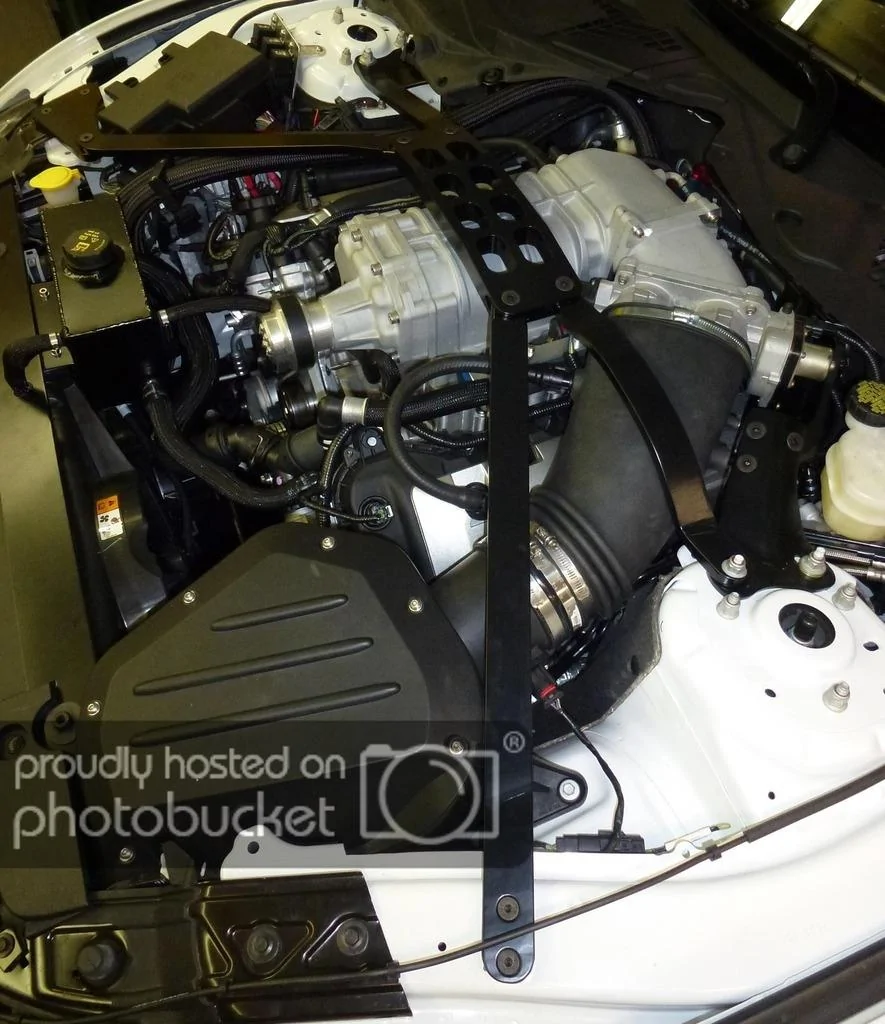

Finally finished the engine compartment with home made strut tower brace and repaired K brace. Ready for tune.
Well that’s it I give up… Thought my shyt was going okay… Just spent the last hour reading thru everything here very nice work. Did you have to lower the engine to fit the SC in there? Or was the ¾” drop just for the heck of it? Love the custom tower brace.

Motor was lowered to clear the STB. Otherwise it can be run at stock height.
The most amazing thing about this combo is that it's with the most inefficient/hot blower out there (stock GT500/M122) and it has IAT's a LOT lower than anything else available. A LOT lower! Nothing else is even close. 550hp with this combo is more HP than 550hp with any other combo. Just think what happens when a top quality head unit is used on this setup (which can be done). The cooler running combo will always make more power more of the time.:thumbsup:

Worst Supercharger for heat production runs cooler than the best Supercharger for heat production. Heat is a inevitable, heat is created when air is compressed. But given the right environment that heat can be controlled. The outside air temperature was right around 70 degrees.
