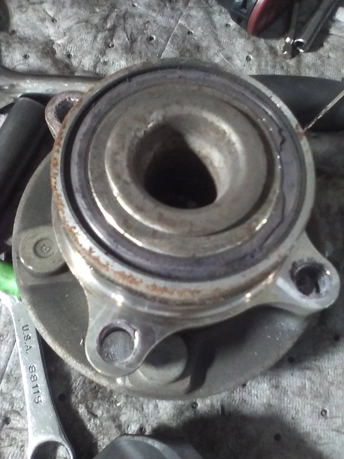

UPDATE...... Went to the dealer this morning. The R/F wheel bearing has come apart. Wheel speed sensor ok.....wheel bearing will be here tomorrow, and I will take back to dealer Wed. morning.

Update.....Dealer got R/R wheel bearing instead of R/F. Car is up on the lift and apart. I asked for the faulty part, but they have to return it for warranty. Dealership was nice enough to put me in a new Bronco til the repair can be finished. I asked to tech to see the faulty bearing and he took me out into the service bay. I snapped a pic of the faulty bearing and I'm posting here because it seems they did not tighten the bearing at the factory which can be seen in the pic by the egg shaped mounting holes. The tech said it was loose and common.

Wheel bearing bolts left loose at factory is not a good sign of quality control. I would ask tech to ensure all other wheel bearing bolts are at proper torque prior to getting car back.
Sadly, there is just no pride in ones work ethics anymore. Being a retired auto tech of 50 years, I took pride in my work and treated every car as if it was my own.

Update......the correct wheel bearing arrived today......According to service writer the bolts used a single use fasteners and they are out of stock with NO ETA..........WTF!!!!!!!!!!!!!!!!!!!!!!!!!!!
