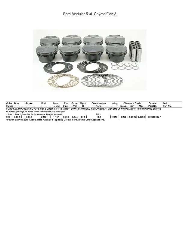

I see a few people have mentioned the Mahle/Voodoo piston setup. Does anybody know what wrist pin the kit comes with??? Looked around and didn't see any information on them...
You will need to run the 5.2 crank to run that piston.
The pistons will work fine with a boss crank .
You will just lose a little bit of compression .
I had a long block built by BPS earlier this year with those pistons/boss crank and Gen I voodoo
I am also building a Gen2 voodoo block with the same combo for my 18 .
You have to use specific Manley rods that are tapered/smaller pin bore with the voodoo pistons.

You are right, the voodoo pistons will work with boss crank. Just be in the hole a little bit. Also as u mentioned, voodoo specific rod needed with smaller wrist pin. .827 vs .866

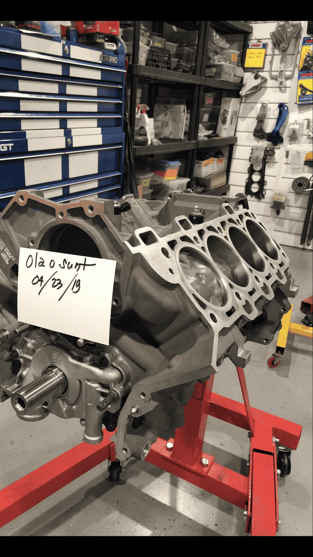

I just pulled the trigger on some drop in Mahle forged pistons for the Gen 3 and the Manley H Tuff rods rated at 1200+ HP.
Sport compact warehouse has 10% off the whole site. Pistons were $668 and rods $750! No tax and free shipping.
Block delivers Wednesday... im stoked to get my build going.

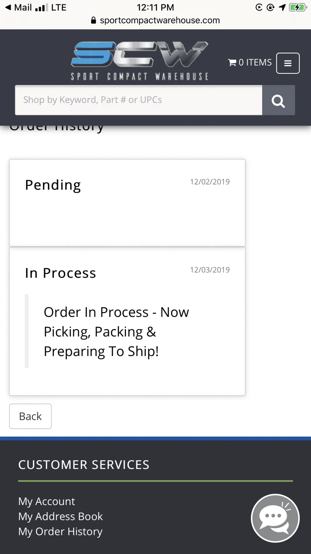

Hey man . Did you ever get your pistons .
They were not in stock when I ordered and they have been “processing “ since 12/3.
gimmie11s
Mar 2, 2018
1,847
1,484
SoCal
Murica!
yeah mine too. SCW is getting the runaround from Mahle. Tbey were supposed to ship on 12/15 and keep getting pushed back a week.
I call every week for updates.
