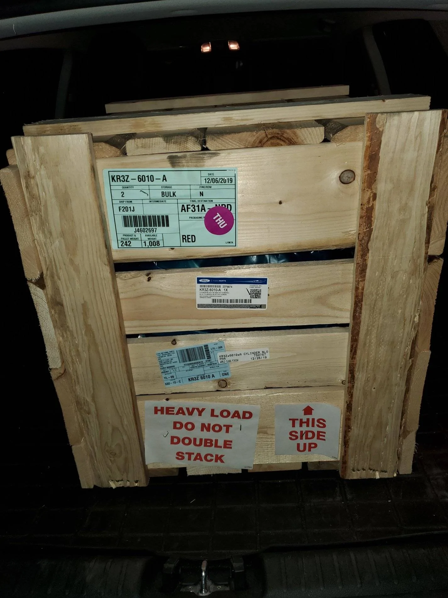

Just stumbled across this thread, lots of good information! I just picked up my predator block from my local dealer this evening. Wanted to grab one of these before the pricing went through the roof...

Mind sharing how much you paid?
