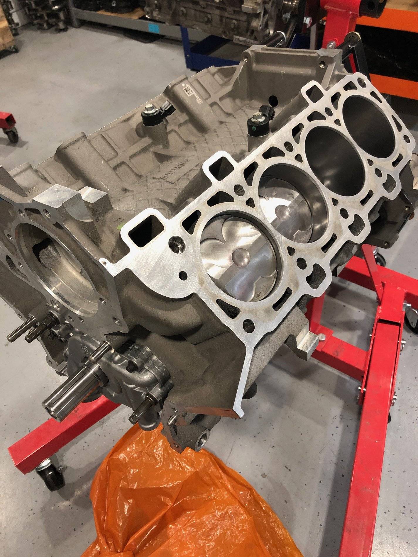

Builder is finishing up my block .
jigiddy jigiddy
wish I could have made it a long block but that’s another $5K
I will just have to swap the heads on my current engine .
Already have the parts to build the stock block(H Tuff rods and waiting on the Mahle pistons ) but still considering that stroker .

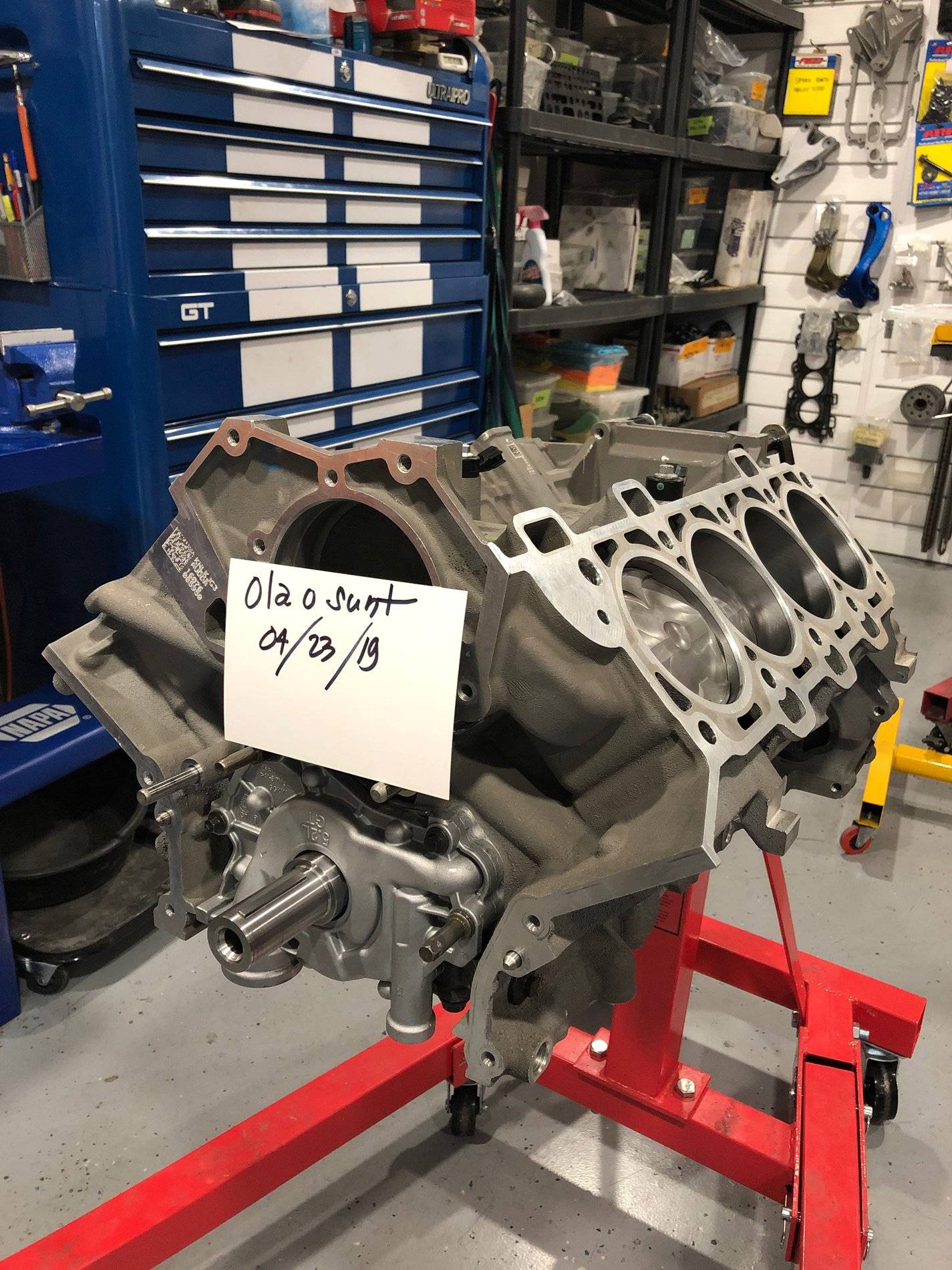

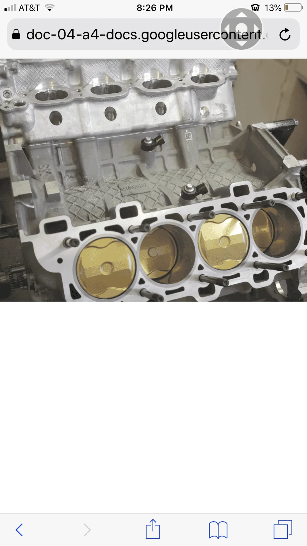

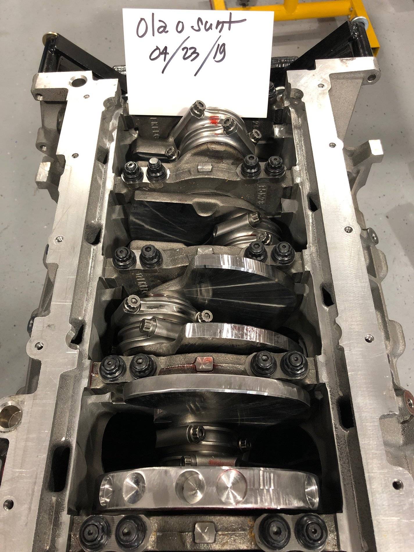

This a cross plane build for my 18 GT using voodoo pistons/Manley rods and the 19 up voodoo block .
I also have the same cross plane combo in a long block that has a pre 19 voodoo block.
The OEM voodoo pistons are made by Mahle.
The motor that is now in my GT 350 has a sleeved pre 19 voodoo block built with diamond pistons and I am building up another Gen I voodoo engine, swapping just the rods, as a spare.
I know the 19 up and predator blocks are stronger than the pre 19 voodoo blocks but I have not heard of anyone cracking the earlier blocks even boosted .
I ended up sleeving the one in my GT 350 now because the cylinder lining was damaged due to a couple bent of rods .

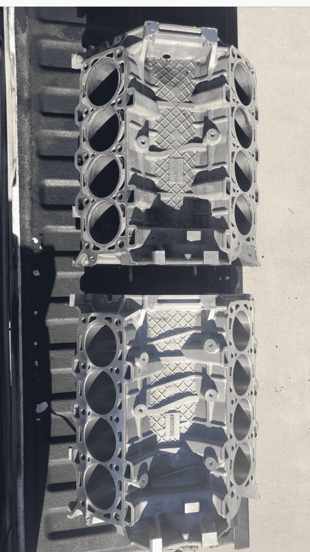

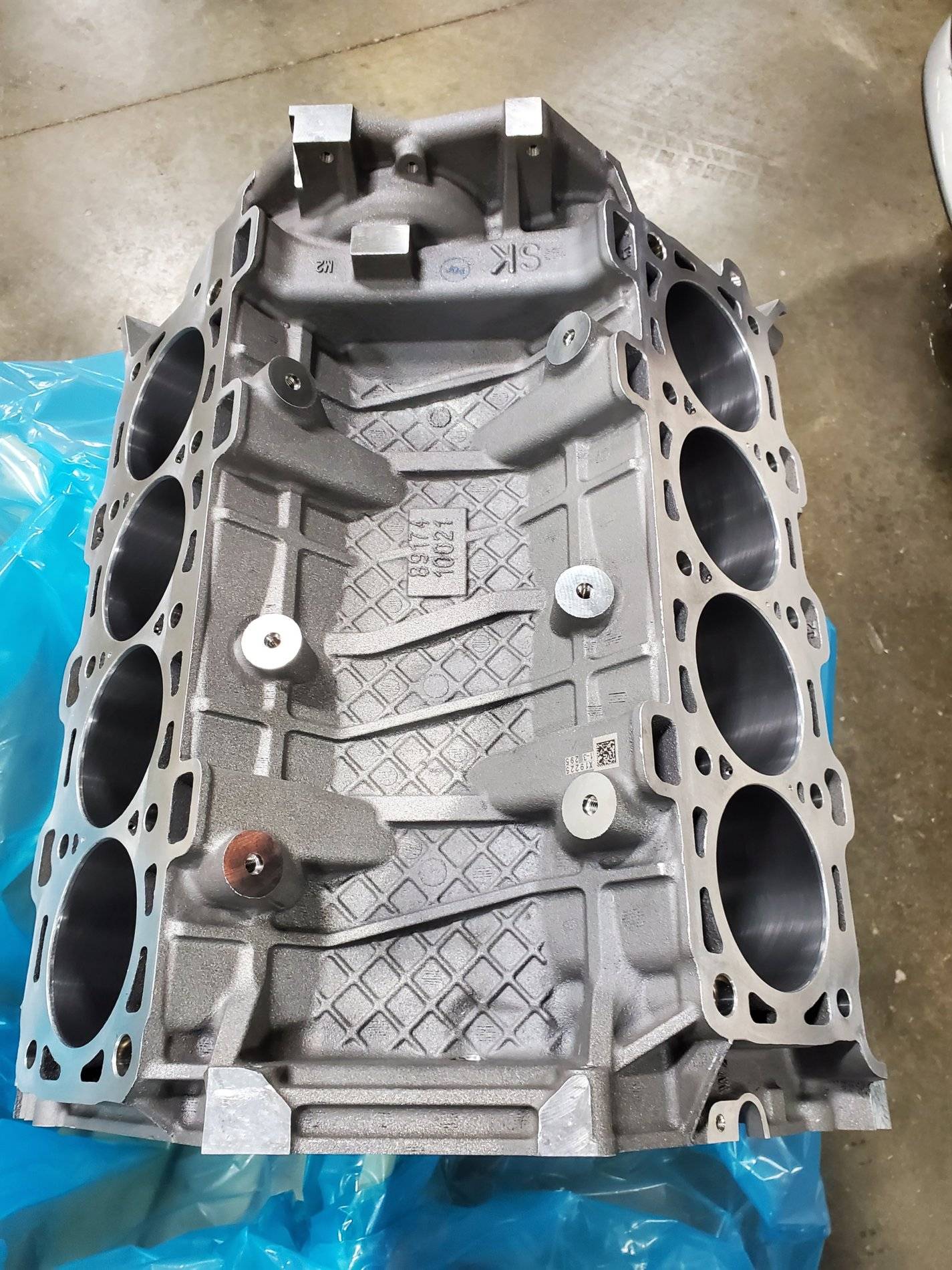

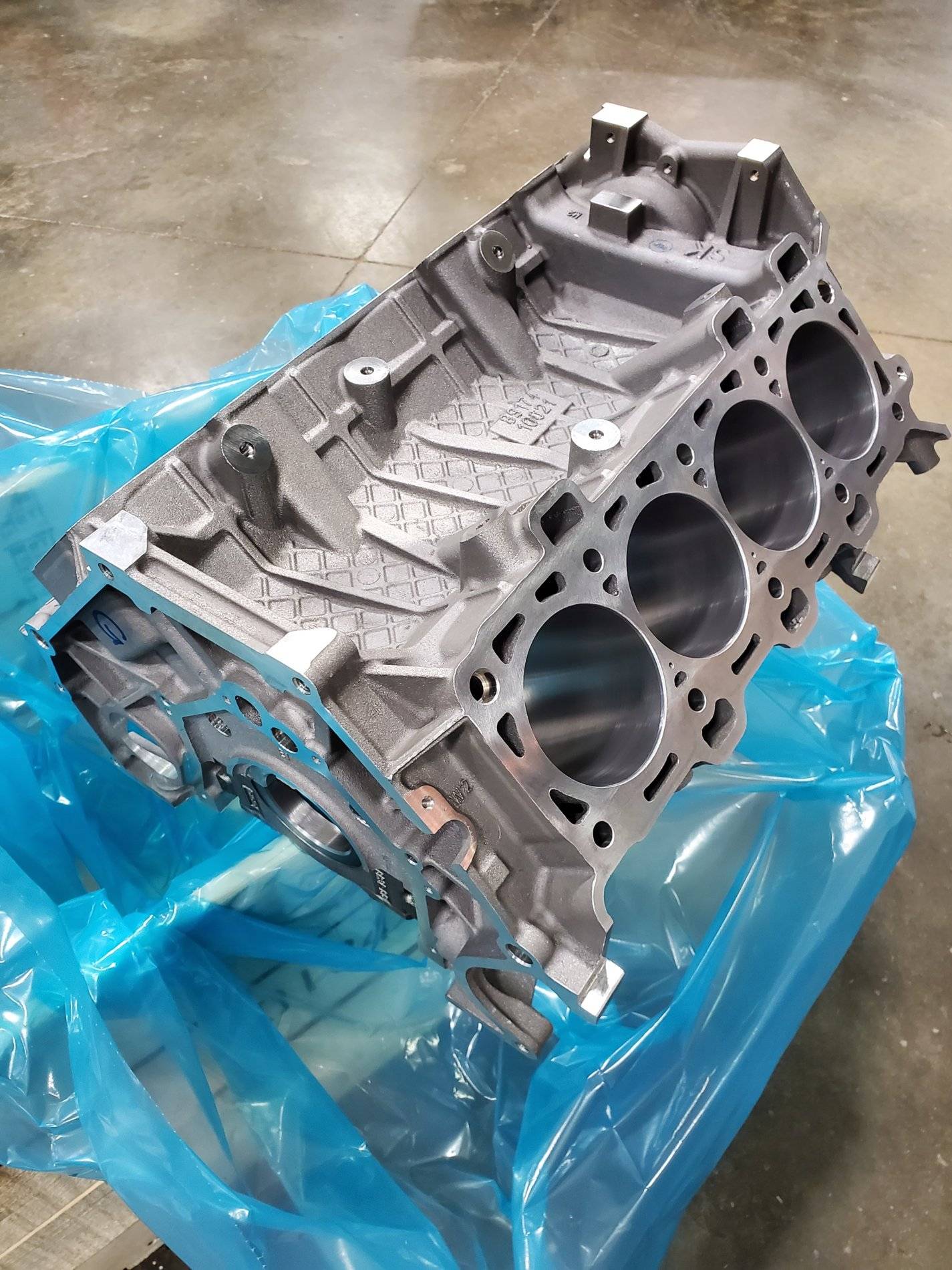

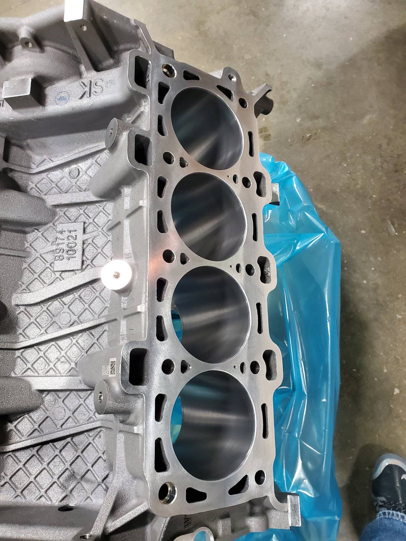

This is the Pre 19 Voodoo cross plane build .
Note the block difference from the 19 up build above
Only 2 bosses for knock sensors /lacks the extra bracing in the valley but is a lighter block .

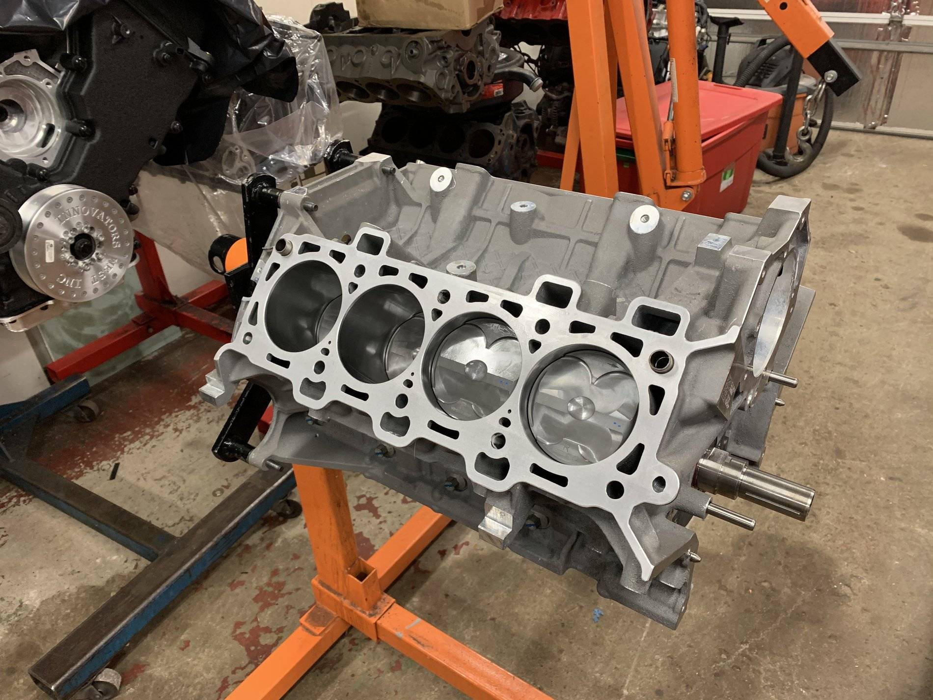

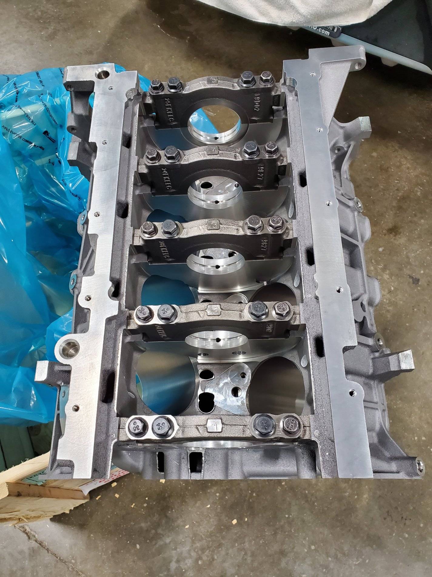

This is the sleeved pre 19 flat plane build
Same manley rods but diamond pistons.

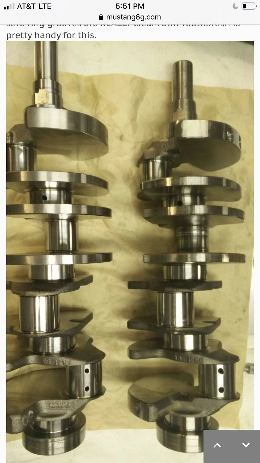

I used a boss crank and not the ford racing 5.2 crank in the cross plane builds .
Compression is down .2 and displacement down about 2cc’s compared to the Alluminator 5.2 XS that uses the 5.2 crank
Boss crank and 5.2 crank side by side .
