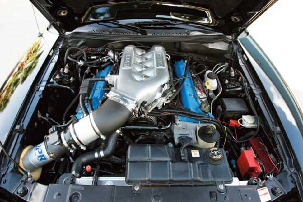

RFXE is experimental engineering. Ford EDO group ( engine development operations) I had a 00 cobra R engine with every part tattooed. Ford is not thrilled when stuff like that gets out. I was attending the PRI trade show in 2011 or 2012 when I first heard about ( a 5 liter 180 degree crank engine ) It was said it was making over 500 hp but there were difficulties keeping things attached to the block. Your XE engine could be 7-8 years old
Heres a pic of that 00R engine in a '96 cobra. Prototype intake manifold. The production part has a smooth top (because this design tended to collect dirt) and the snout was longer

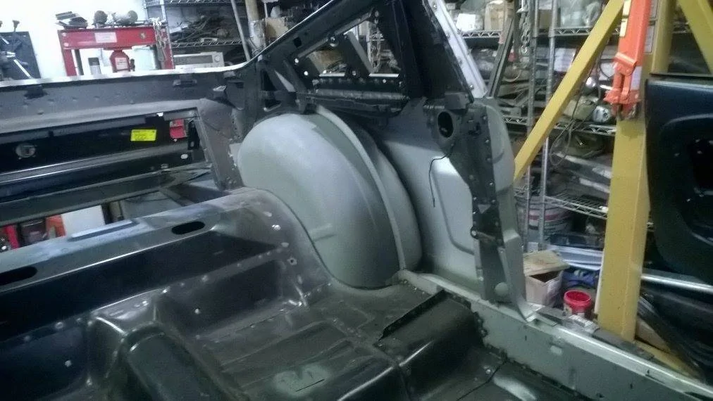

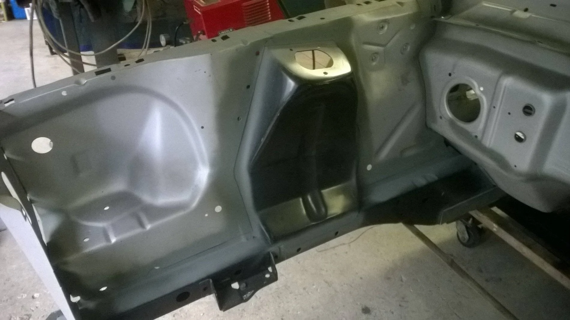

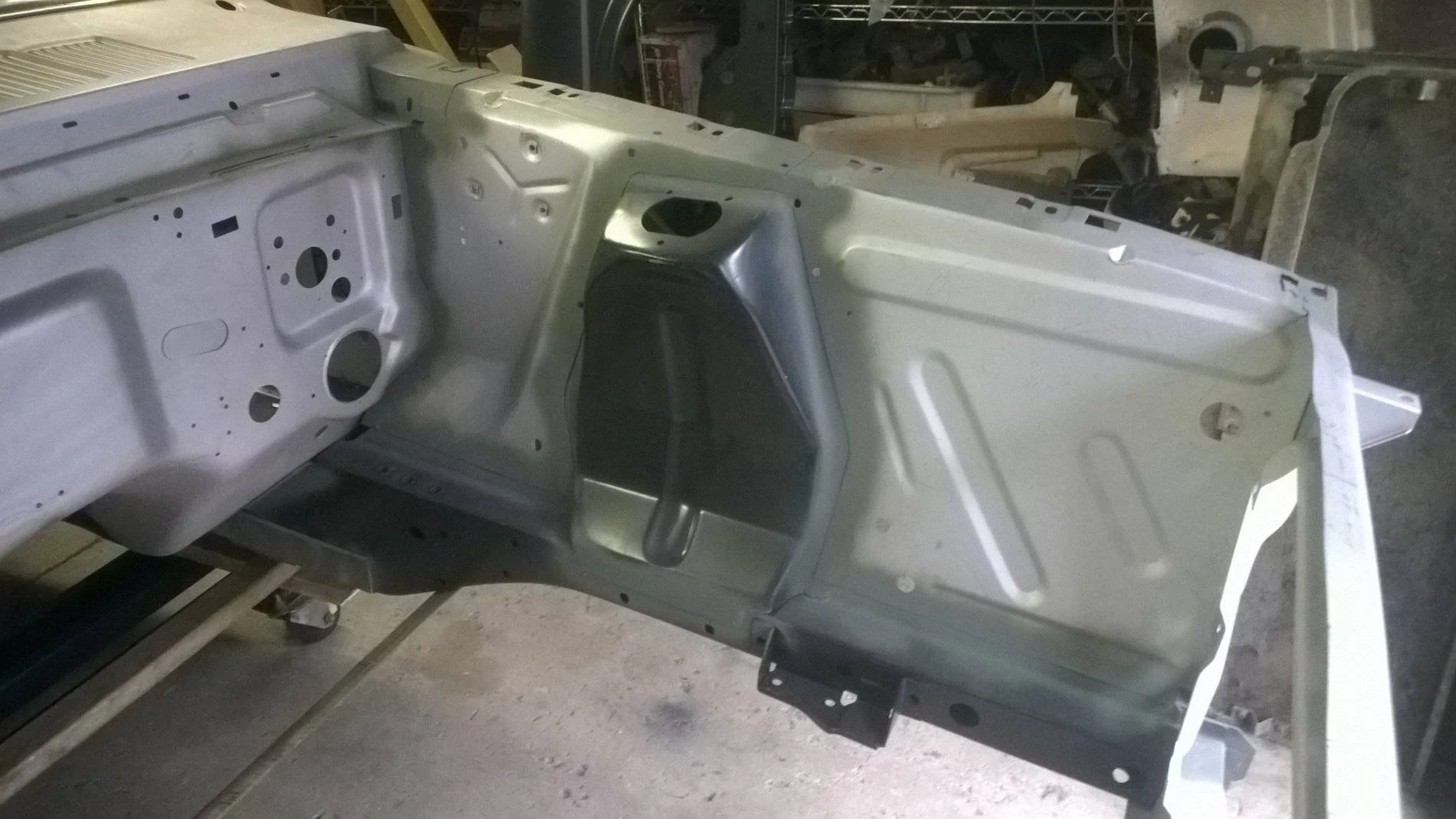

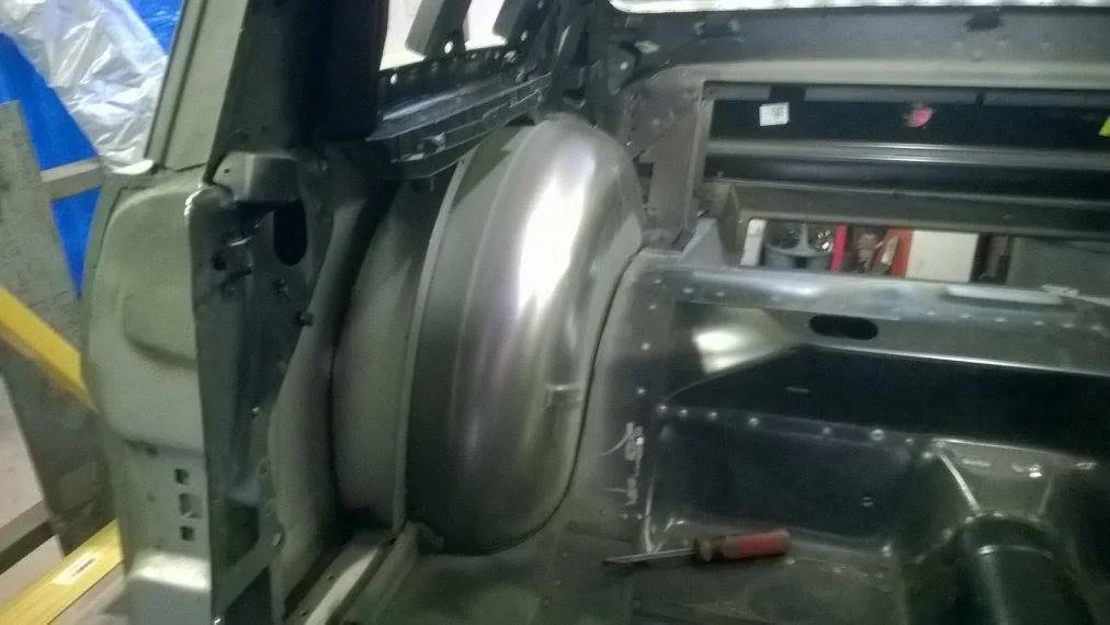

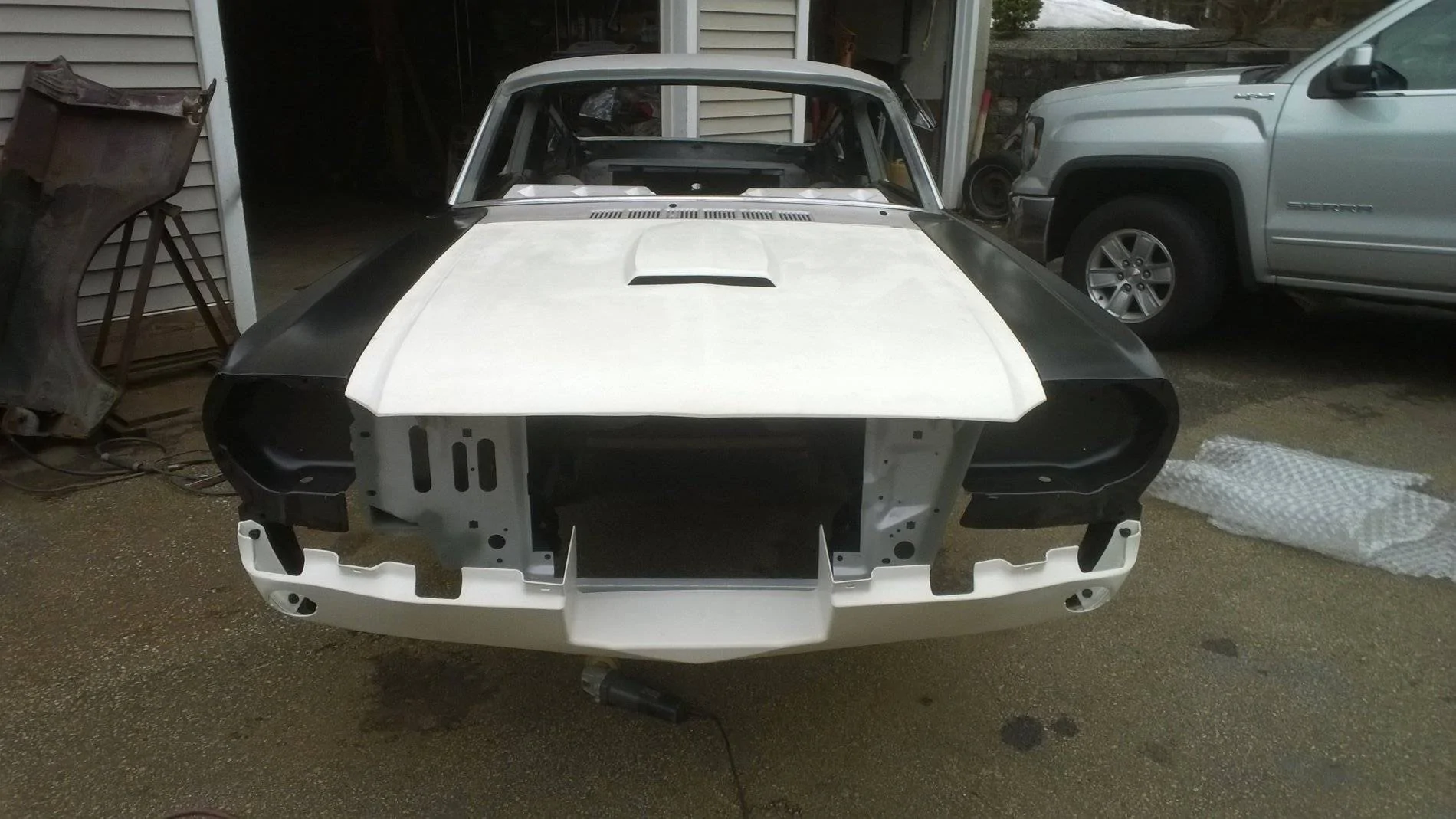

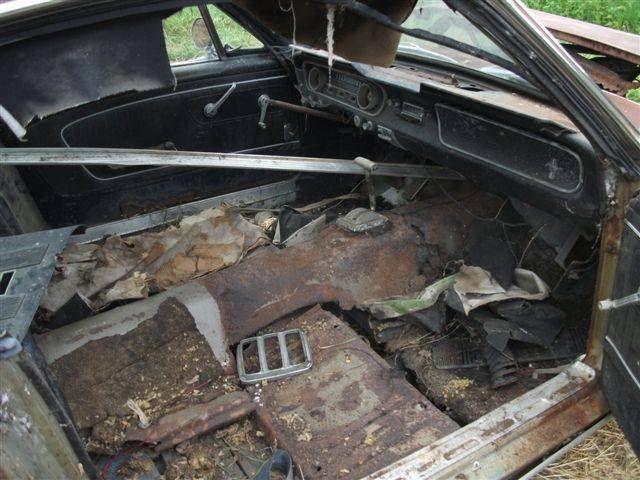

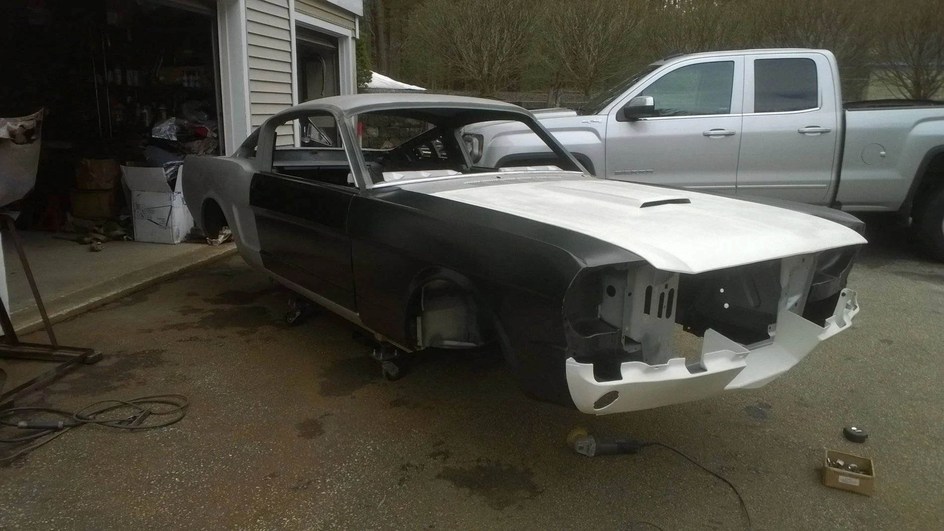

Here are some pics of the 65 it is going in,
68 big block towers
68 core support with larger radiator opening
DSE mini tubs to hold a 315 tire
I plan to run the 5.2 with gt350 trans I picked up. Also going to run the gt350 radiator and fan and also the oil and trans cooler from agt350. The should look good in the opening of the Shelby front valance,
