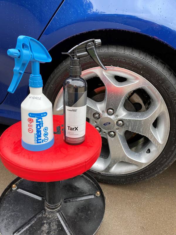

If it was me, I would be using CarPro TarX.
https://carpro.global/catalog/tarx/
https://www.obsessedgarage.com/collections/decontamination/products/c7-carpro-tar-x
This will be safe on your ceramic coating.
Soak some into a microfibre towel, dab the area to be treated and let it soak for a few minutes. Reapply in this method to allow the product to loosen the adhesive. Then use a microfibre to start removing the adhesive. You may need to repeat this process a couple of times depending on how stubborn the adhesive is.
Doing it this way will help avoid stronger chemicals (no brake cleaner please), prevent damage to the clear coat and preserve you ceramic coating.

I like this....I’m going to give this a shot!! Thank you!!
