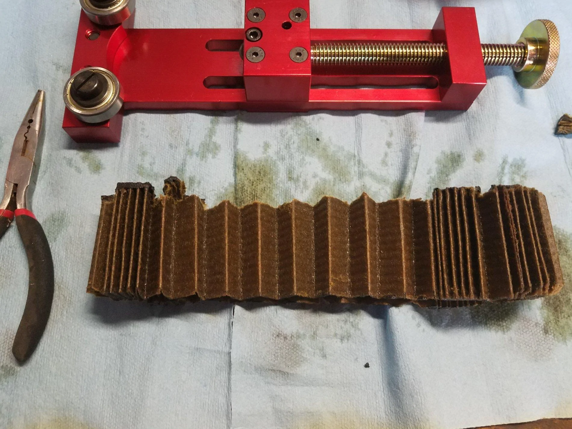

3K on the motor, nice central coast weather today, so I decided to change the oil in the Bullitt. 5w30 motorcraft, FL-500s filter, and 2 cans ceratec. The engine had no prior ticks or rattles or any weird sounds for that matter compared - at least compared to any of the videos out there. But it did have a intermittent light knock(?) sound every now and again that sounded like something off of a pulley. The engine possibly seemed to run a little smoother after the oil change and ceratec, but it idled smoothly before so its tough to call. Here's the opened filter in the pix. (Ordered the filter cutter from amazon) Seems like a normal amount of new engine casting flakes to me. If it has this many flakes in the next oil change I will probably get an oil analysis just to know what's going on.
I think a BMR front k-brace and some BG Syncro shift II for the tranny will be the next project -but in the meantime - All is good with the Bullitt!

Nice work. One thing I like to do when I inspect a filter is unravel the media, like you have, then clean it off thoroughly with a clean, stiff brush in a pan of fresh solvent (mineral spirits works good, but beaucoup expensive in California if you can even find it). Then, stir a strong magnet around in the solvent to pick up all the metal (except for non-ferrous). A little easier to judge how much swarf you're getting. In a 'fresh' V8, I wouldn't want to see any more than a level teaspoon at most.

Are all the white specs metal?
Tried a magnet?
