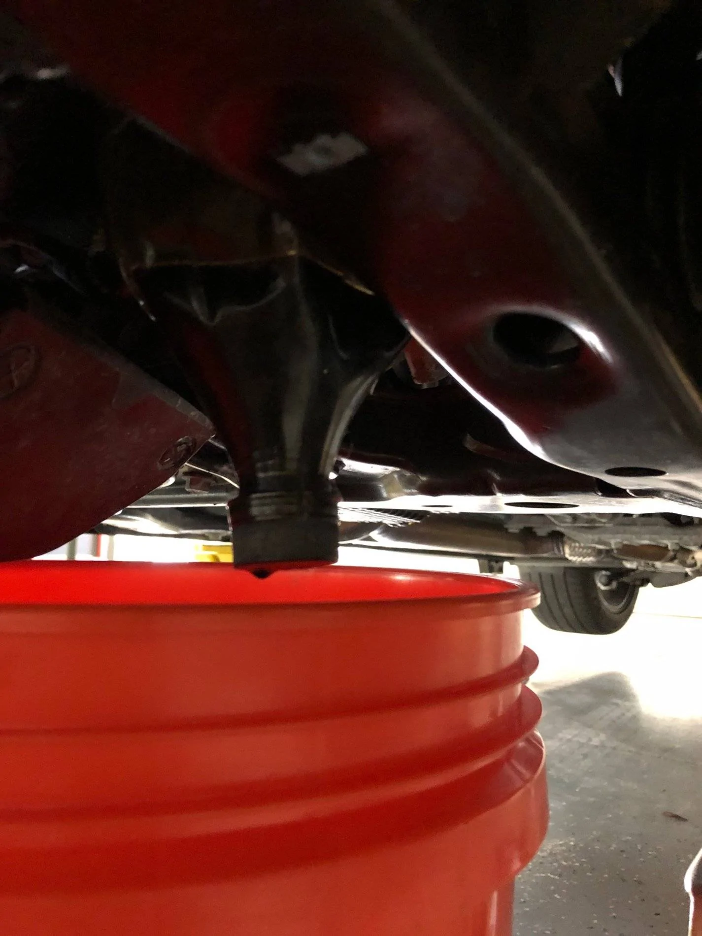

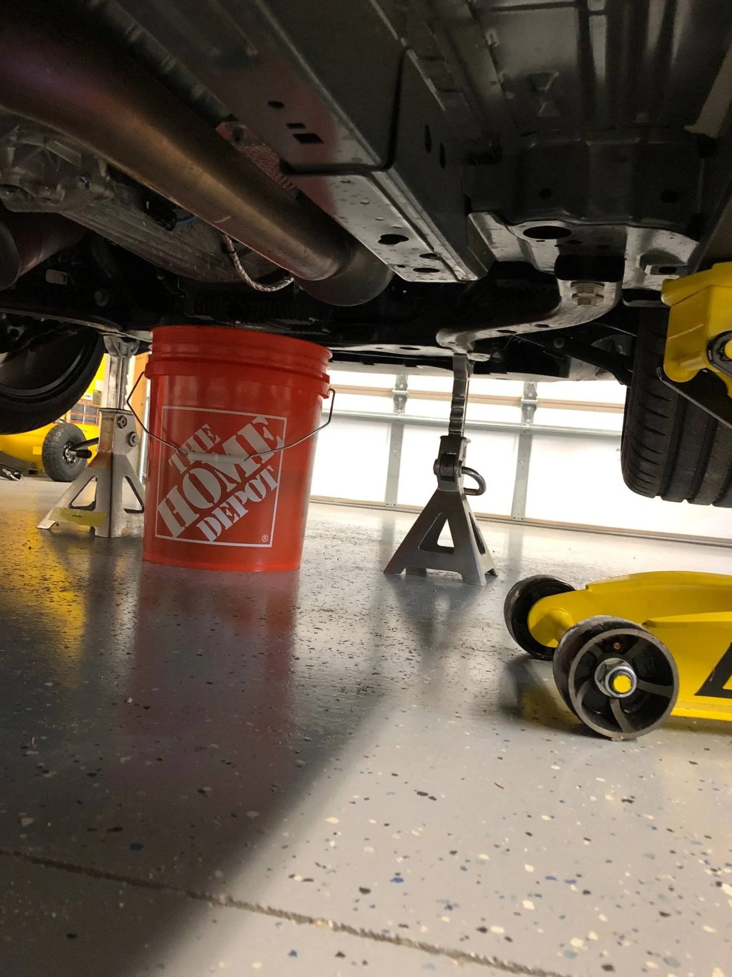

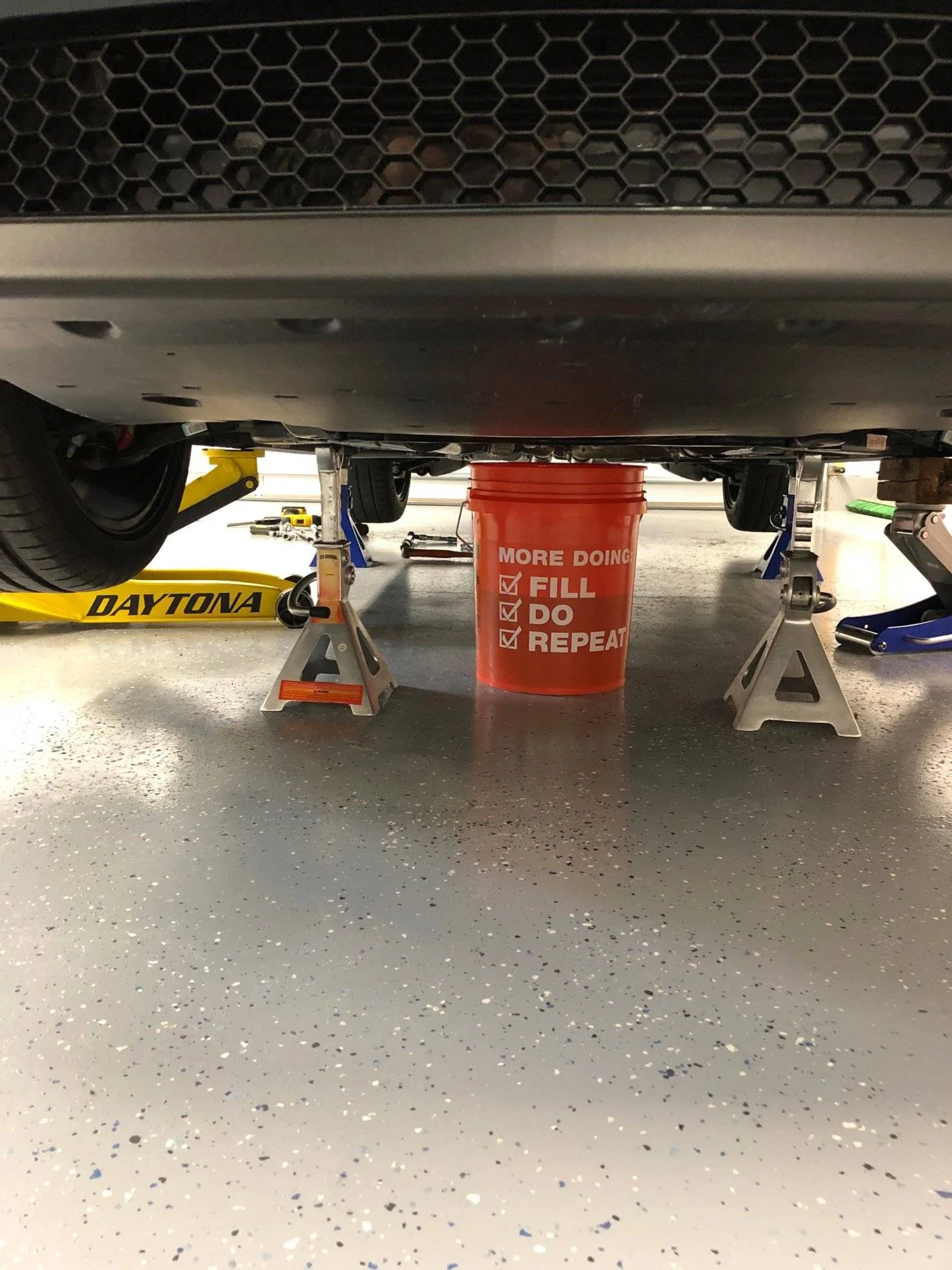

I did my first oil change on the Bullitt today. I did a little research and watched a number of videos of people performing their first oil change on the newer mustangs with the new drain plug and 10 qt. oil pans. They all made a mess and I vowed not to let that happen. I ended up not spilling a drop thanks to getting up high enough on jack stands to fit a 5 gallon bucket under the car. I used Penzoil 05w-30 ultra premium full synthetic. Car had just over 1200 miles and oil was very black, glad I didn't wait too much longer. I installed a Ronin drain plug so I can use a regular drain pan for future oil changes. I've always used a 2 liter soda bottle with the bottom cut out to encase an oil filter and remove it while inside the bottle to contain the oil and wasn't sure if it would work on this car but it did. I always fill the filter before installing also. This was also very helpful https://www.amazon.com/gp/product/B06VY839T8/ref=ppx_yo_dt_b_asin_title_o07_s00?ie=UTF8&psc=1 Anyway, just thought I'd share.

I have to say - dumping oil into deep bucket with that plastic large diameter plug is an excellent idea I haven't thought about before. Fist time I've done, my drain pan have overflown, then I mastered holding the plug just right to slowly drain the oil.... This is great.
