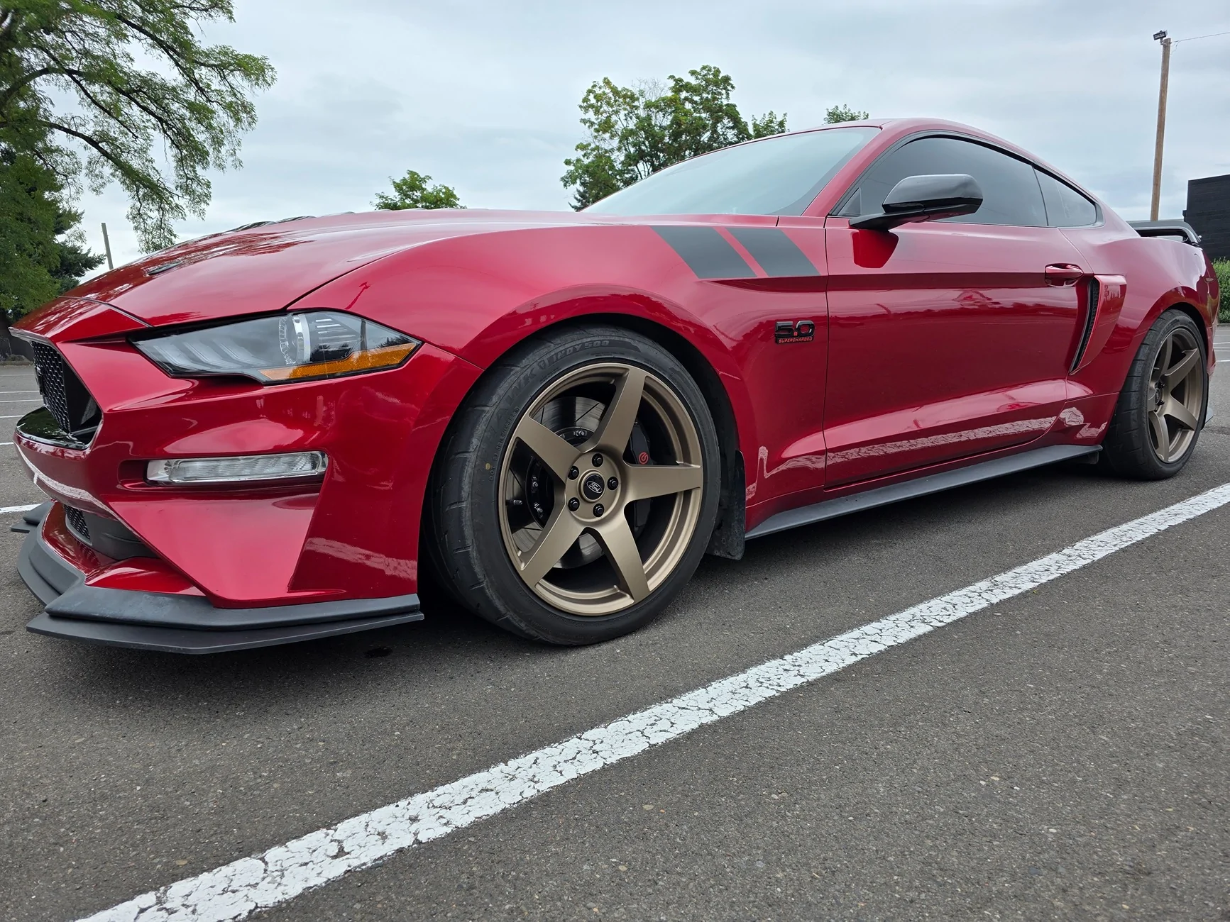

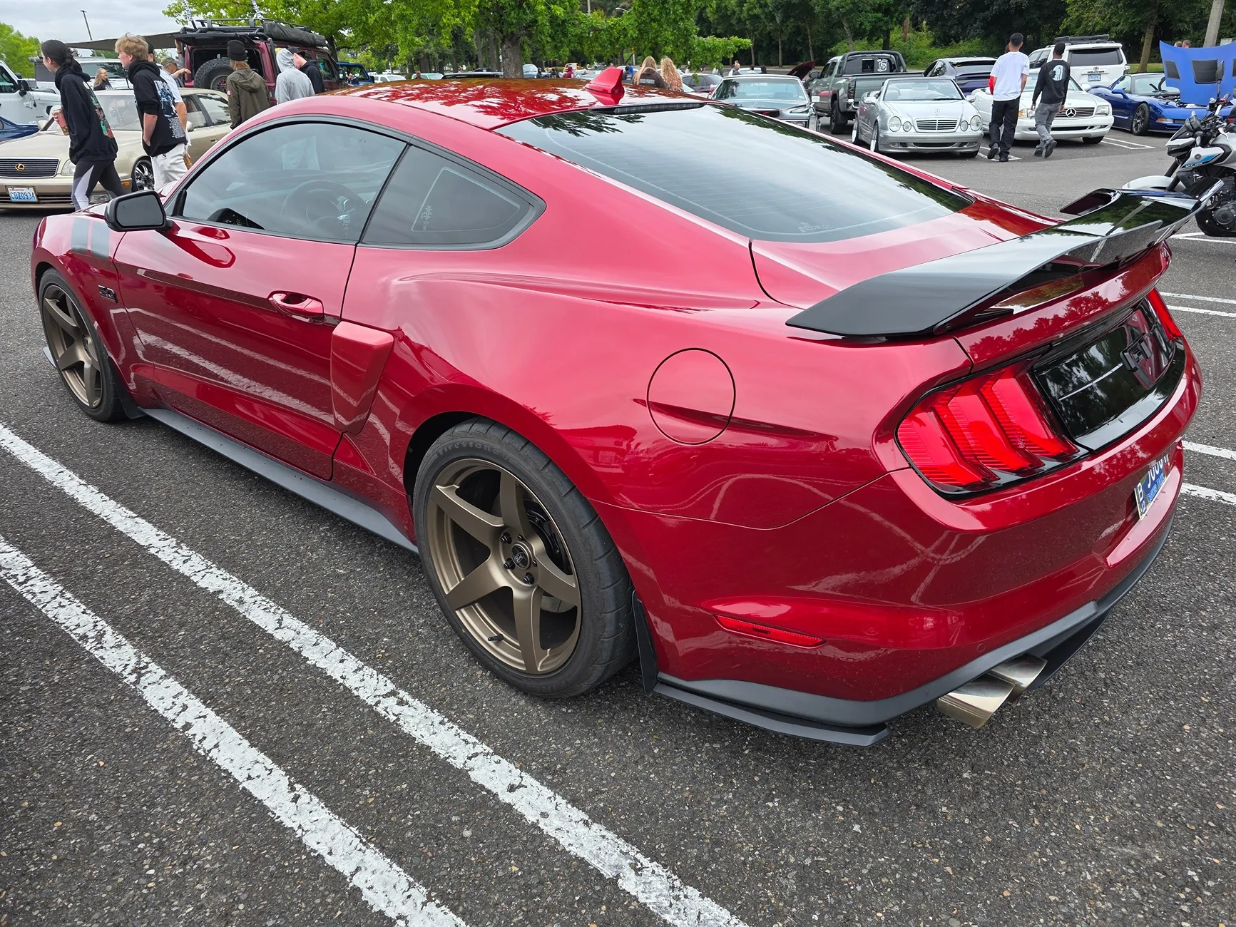

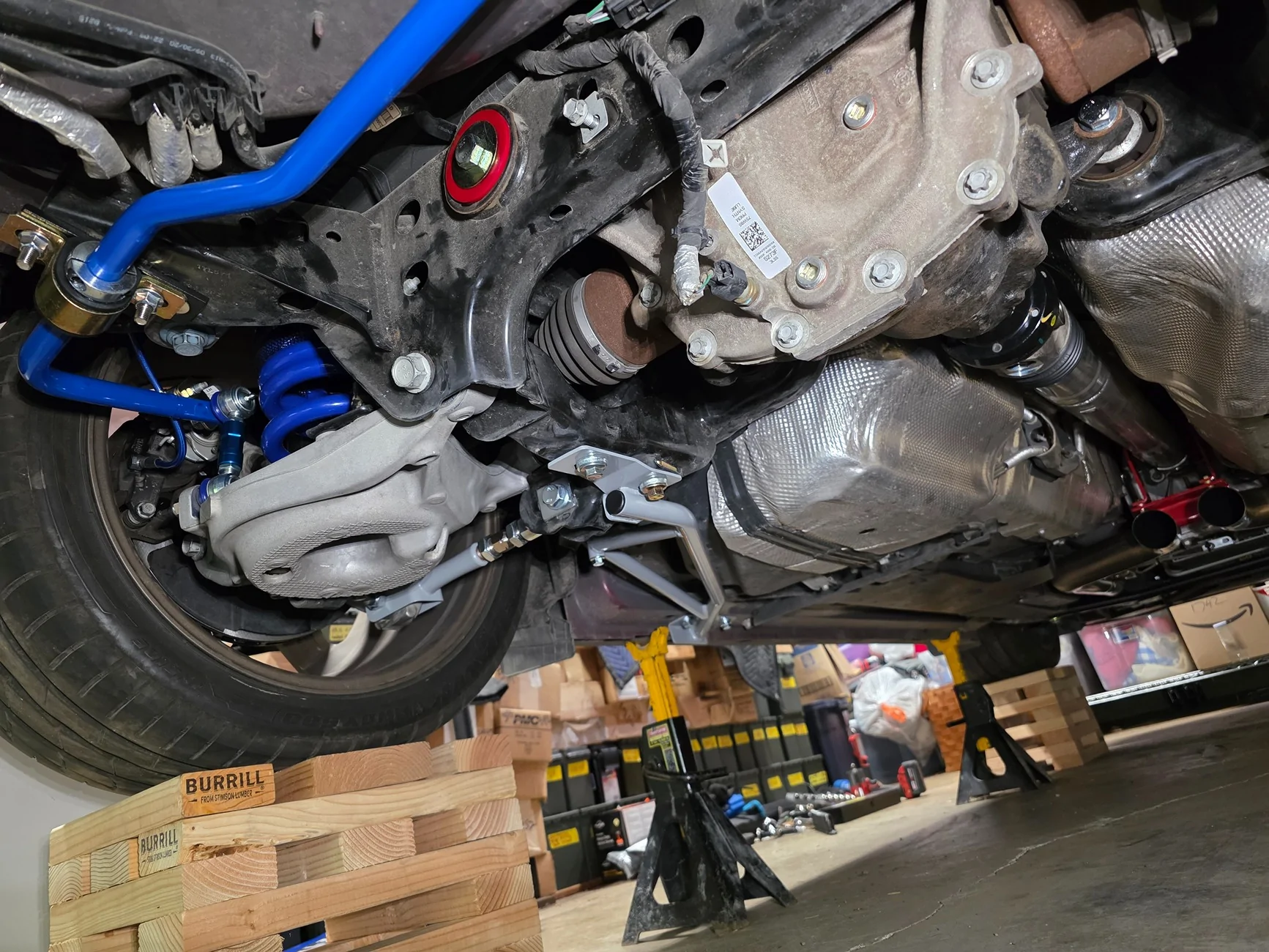

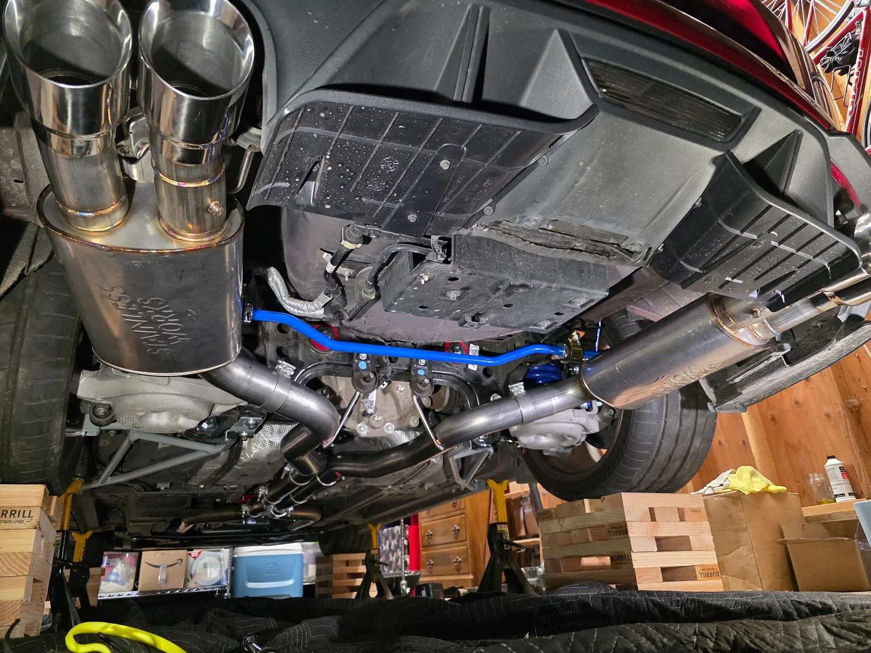

I have the LMR wheel package with the Indy 500. The rear is the 325 and no rubbing. My car is a 2021 PP1 Magnaride with pretty much everything Steeda sells for the suspension including the dual rate spring. They look great and work perfectly. I really need slicks for the back but I am set up for track vs drag. Even with 3 of my 5 kids riding along still no rubbing.

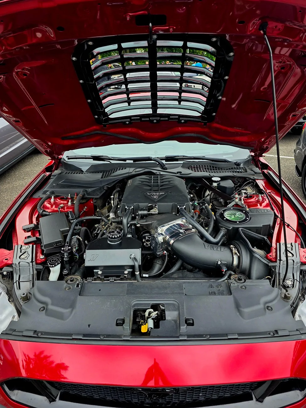

WOW! Love your engine bay. Super clean and well-appointed!

Regarding the FS Indy 500 in 325 fitting the 11 inch wheels I have. The fit is perfect. Maybe variation in sizes between brands would have a different fit. I don't have any mushrooming or pulling. Sits just right.
