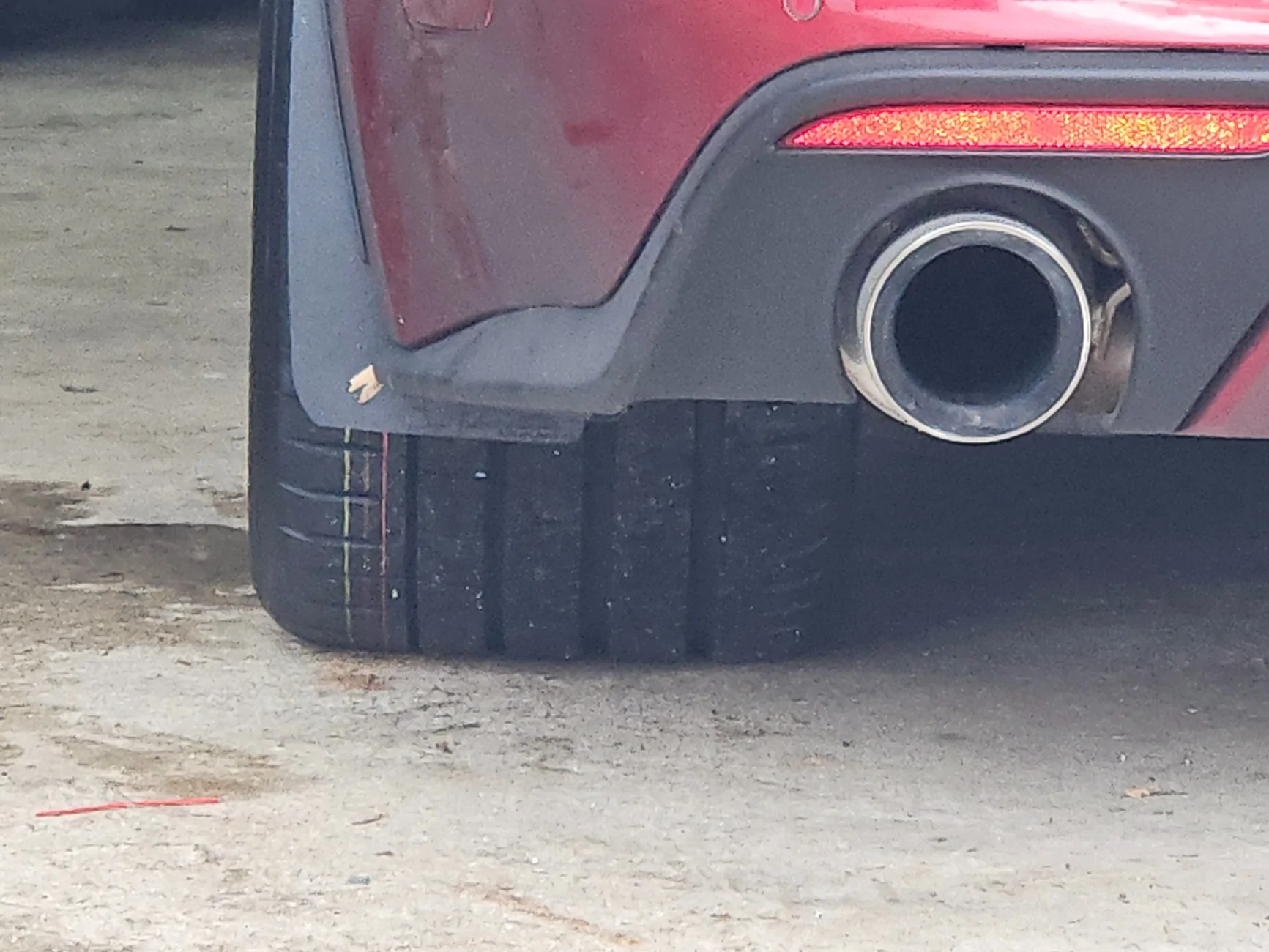

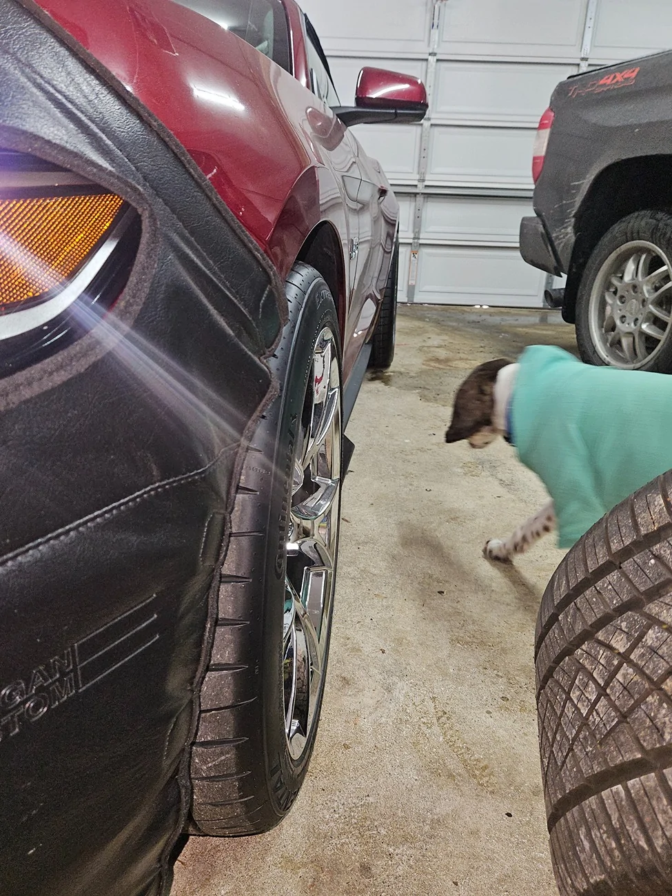

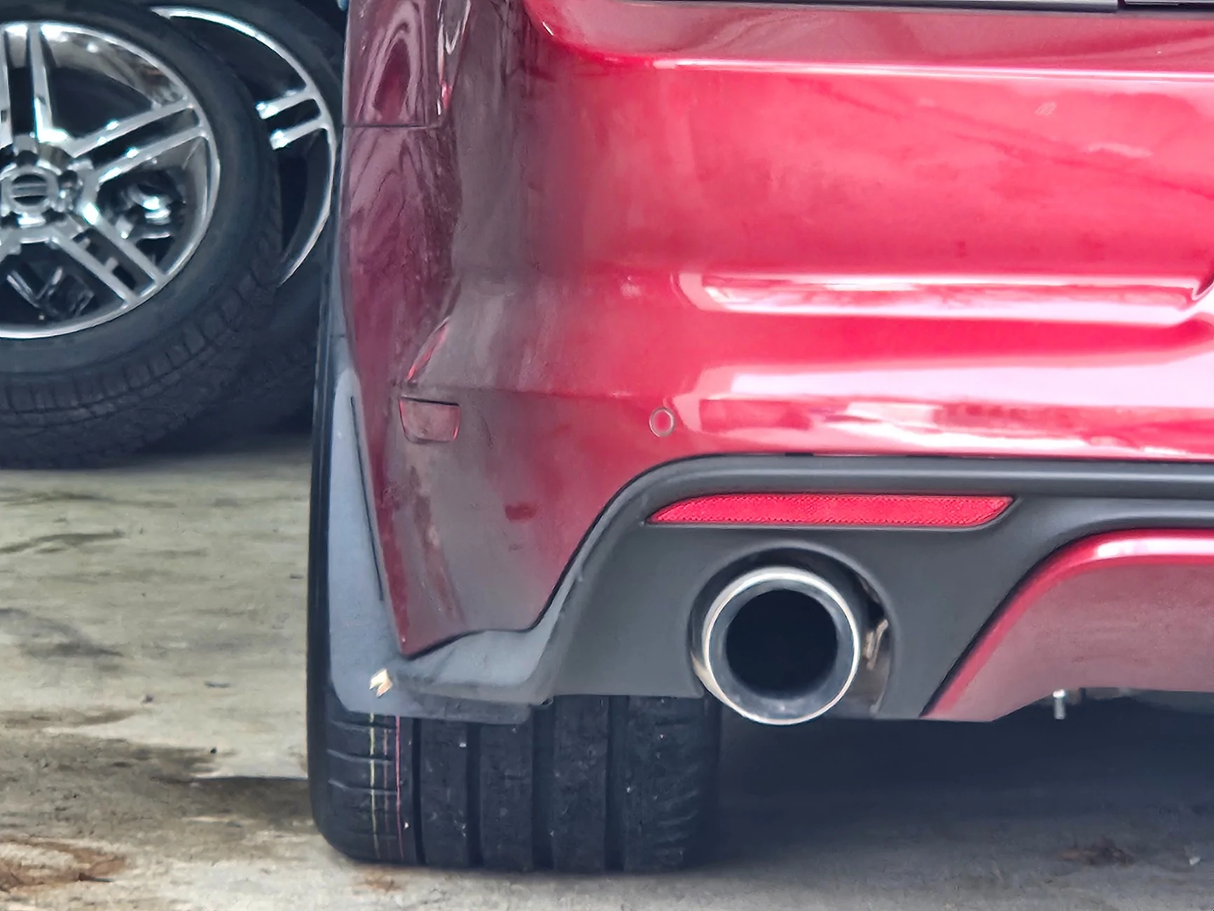

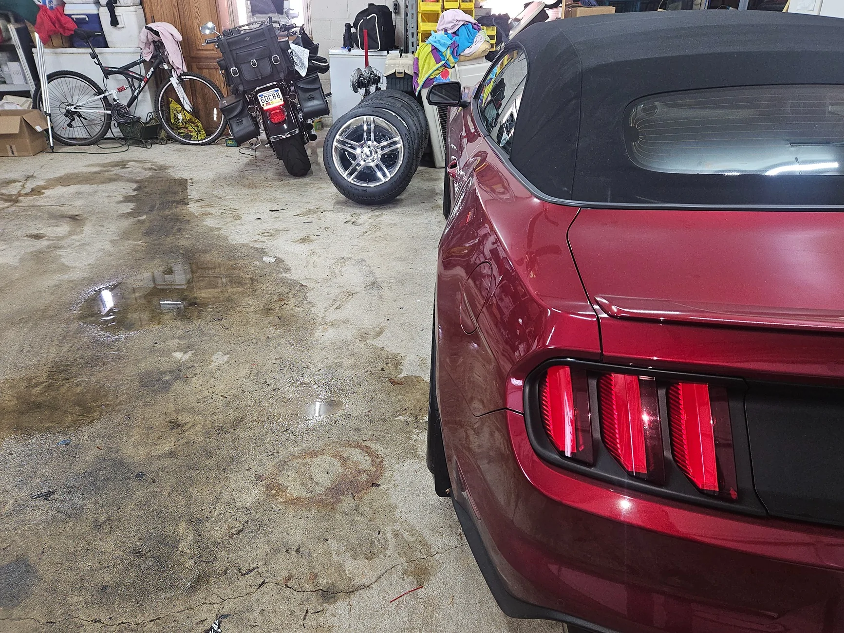

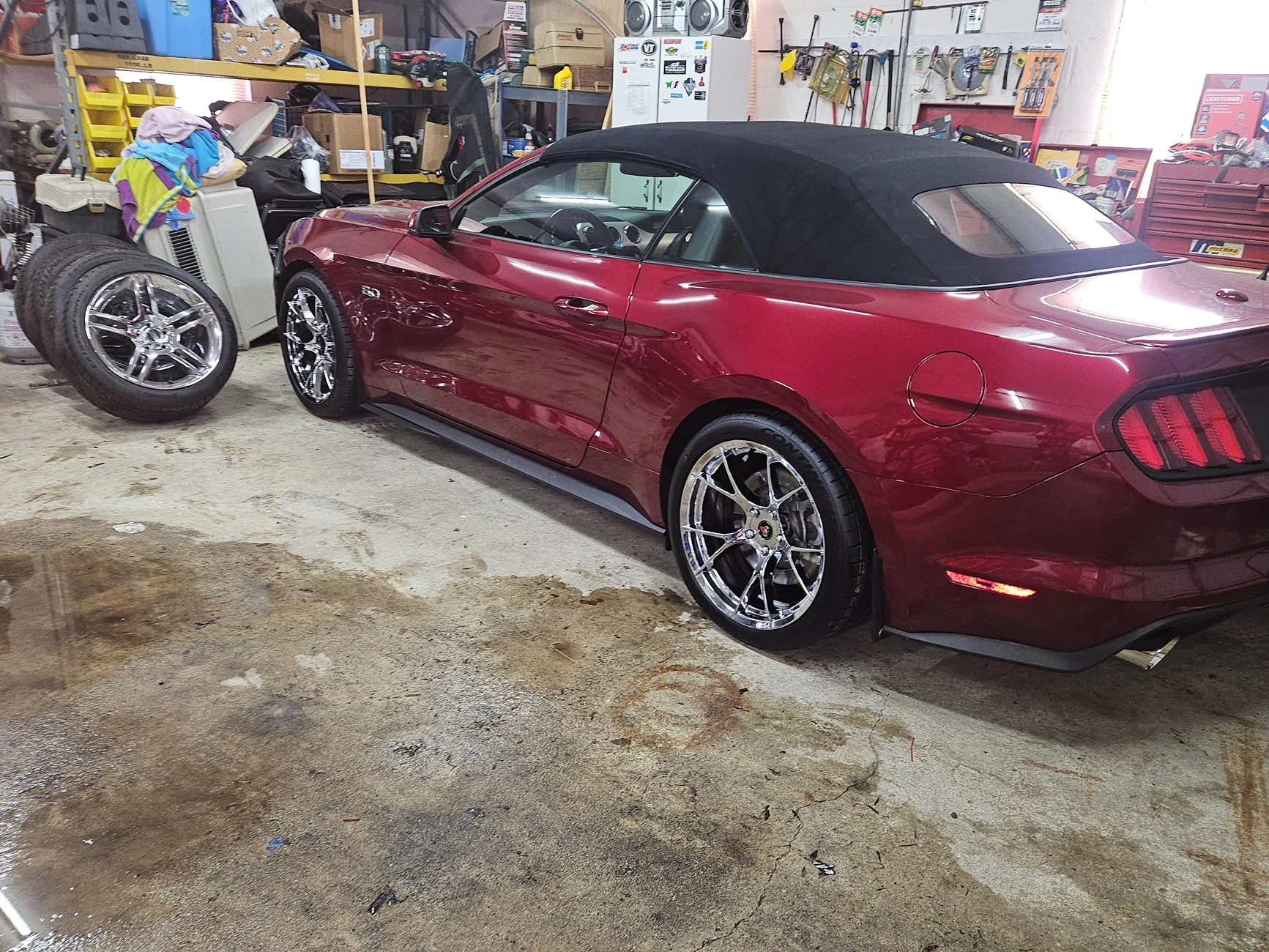

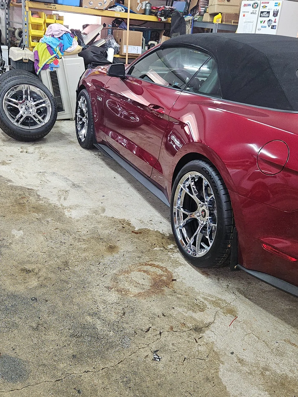

Project GR6 10 spoke wheels. 19x10 et35 front and 19x11 rear et 50. Tires, 285/35 front and 325x30x19 Conti DW02s. I installed a 5mm spacer on the front to bring the front out just a tad. Makes the front offset 40.. I may or may not leave the front spacers on. Not sure yet. Right now, the front and rear poke about 1/8 of an inch at the top.
I pretty sure the 5mm spacer makes the offset 30 now. I have 19*10 +40 with 275/40 and use a 5mm spacer as the tire is VERY close to the strut. I do like the chrome wheels! SOOOOOOOOO much better then black!!
