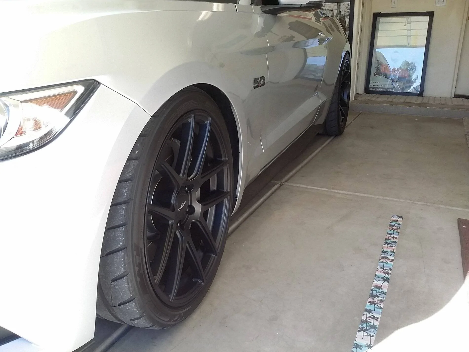

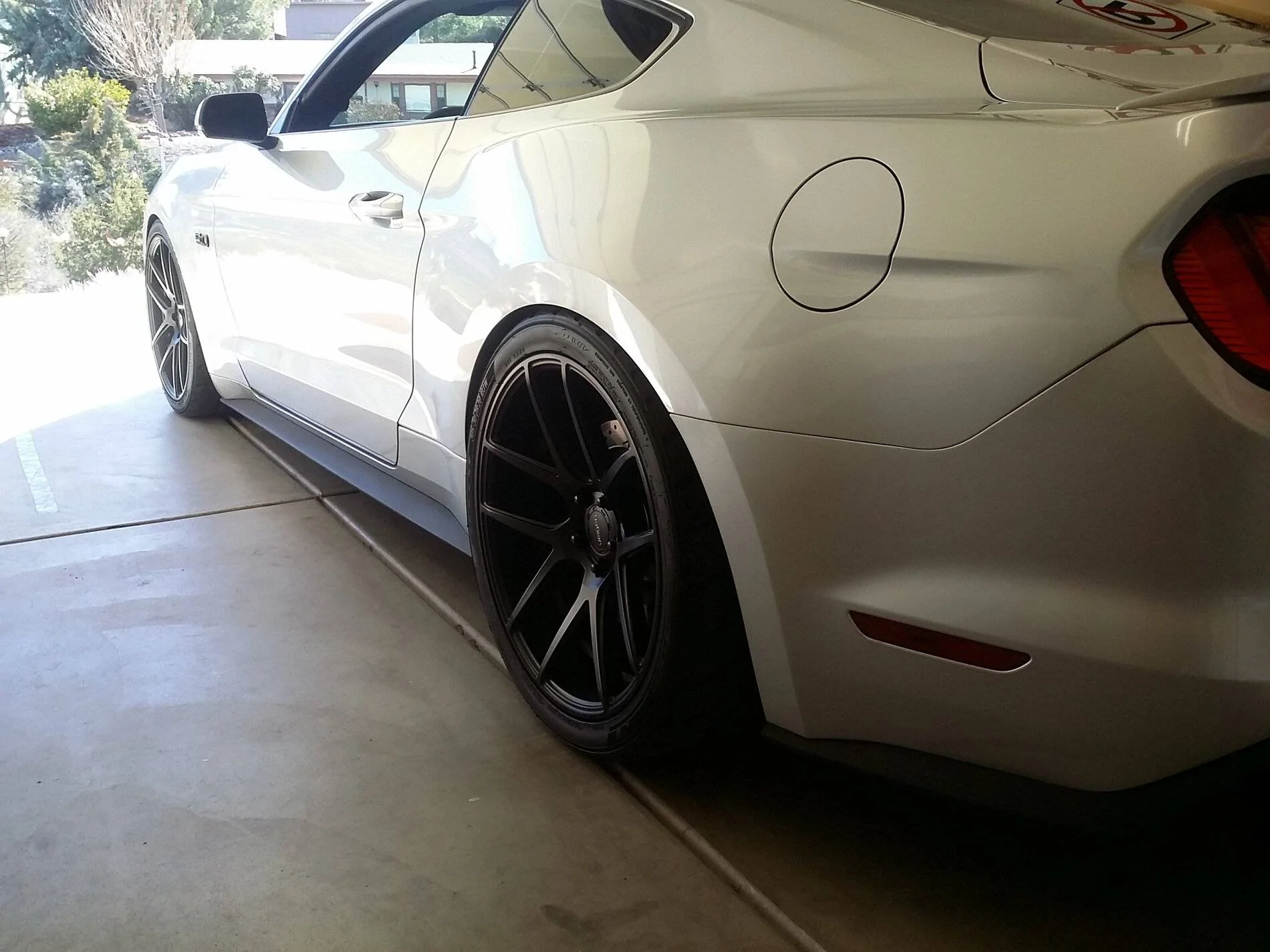

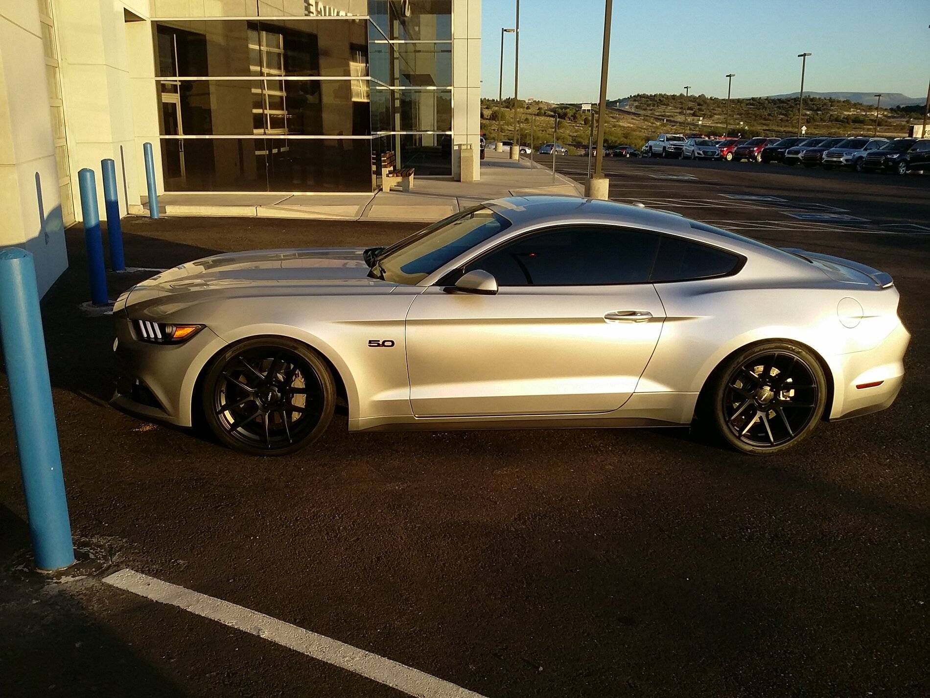

Depends on your off set , for comparison I used a tire cacultor to compare the tires with my set up . I am on 20 and running sport line springs 1.5 drop . What you want to run are shorter and wider then what I am running . Again it will depend on off set if you get a rub . Picture below for comparison. Fronts 255/35 rears 305/30

Thanks for the post man! I'm getting the SVE SP2 wheels they are +35 front and +50 rear.

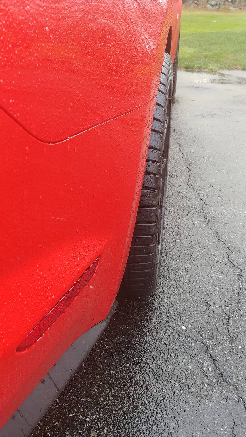

325s with SVE 11" offset will rub lowered. At stock height like mine it's ok, but not lowered.
You need like a 55-60 offset in the rear to make it flush with that kind of tire.

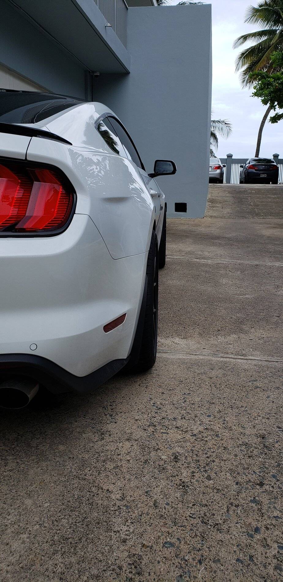

325/30, 48 offset and -2° camber on Steeda min drop (0.5" drop). No rubbing

Your tire has a huge gap between the top and the fender/quarter line. Are you sure you’re rubbing? Or do you mean you’re poking?
No, it's not rubbing because as you said there's a large gap between the top of the tire and the fender. That's why I mentioned it's ok at stock ride height, but if you're lowered it will rub. It does poke a bit outside the fender.

1 inch lower isn’t going to make it rub. The Stock tires at 275/40 have a much taller diameter than 325/30R19 you are 100% incorrect. No offense. Matter of fact I ride 11in SVE 19s with 305/35R19 in the rear same size and offset as op posted and those are on a .7inches taller tire which is 305/35 than 325/30 in diameter on the same size wheel and I’m .78inches lowered and I am fine with stock diameter which was over an inch and a half taller than 325/30 in diameter and still there was zero rub and space left. Diameter is all that matters in regards to rub. And zero issues. I have a good amount of space actually. Many people ride that size in the rear on those wheels. LMR sells a 325 package bundled with them. Which I assume is what the op ordered. Seems like maybe you misunderstood the question. You seem to be speaking about poke from the pic you showed and the statement of being flush.
