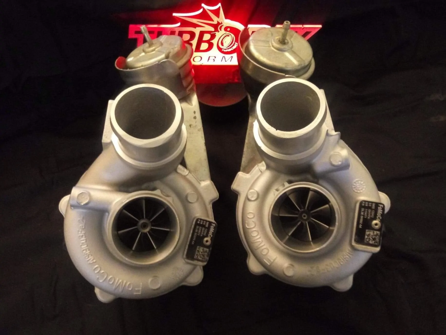

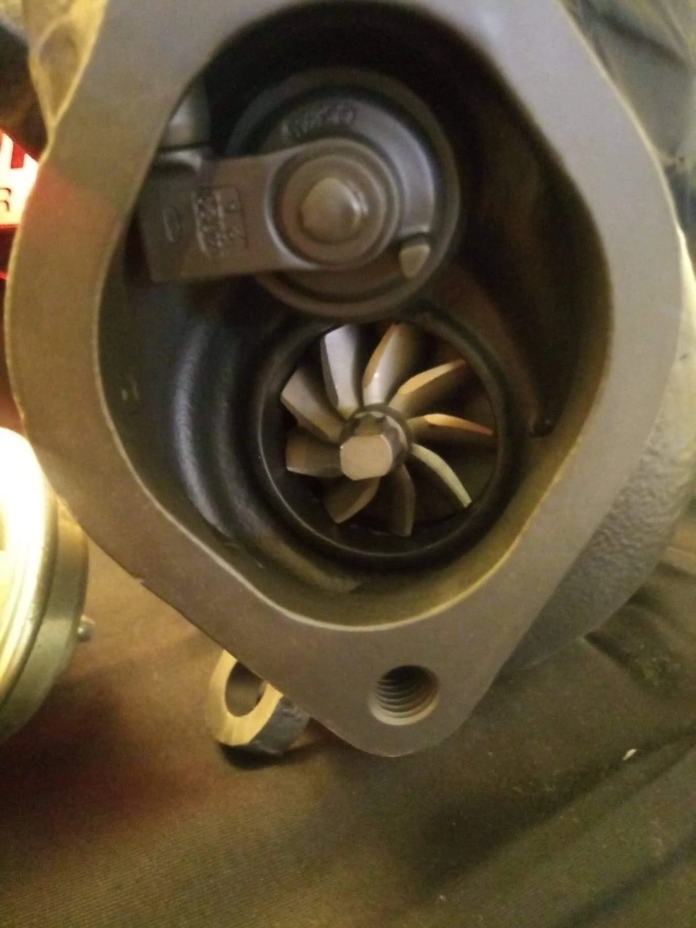

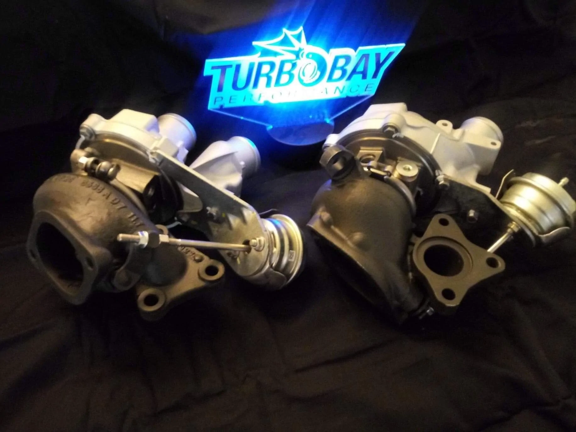

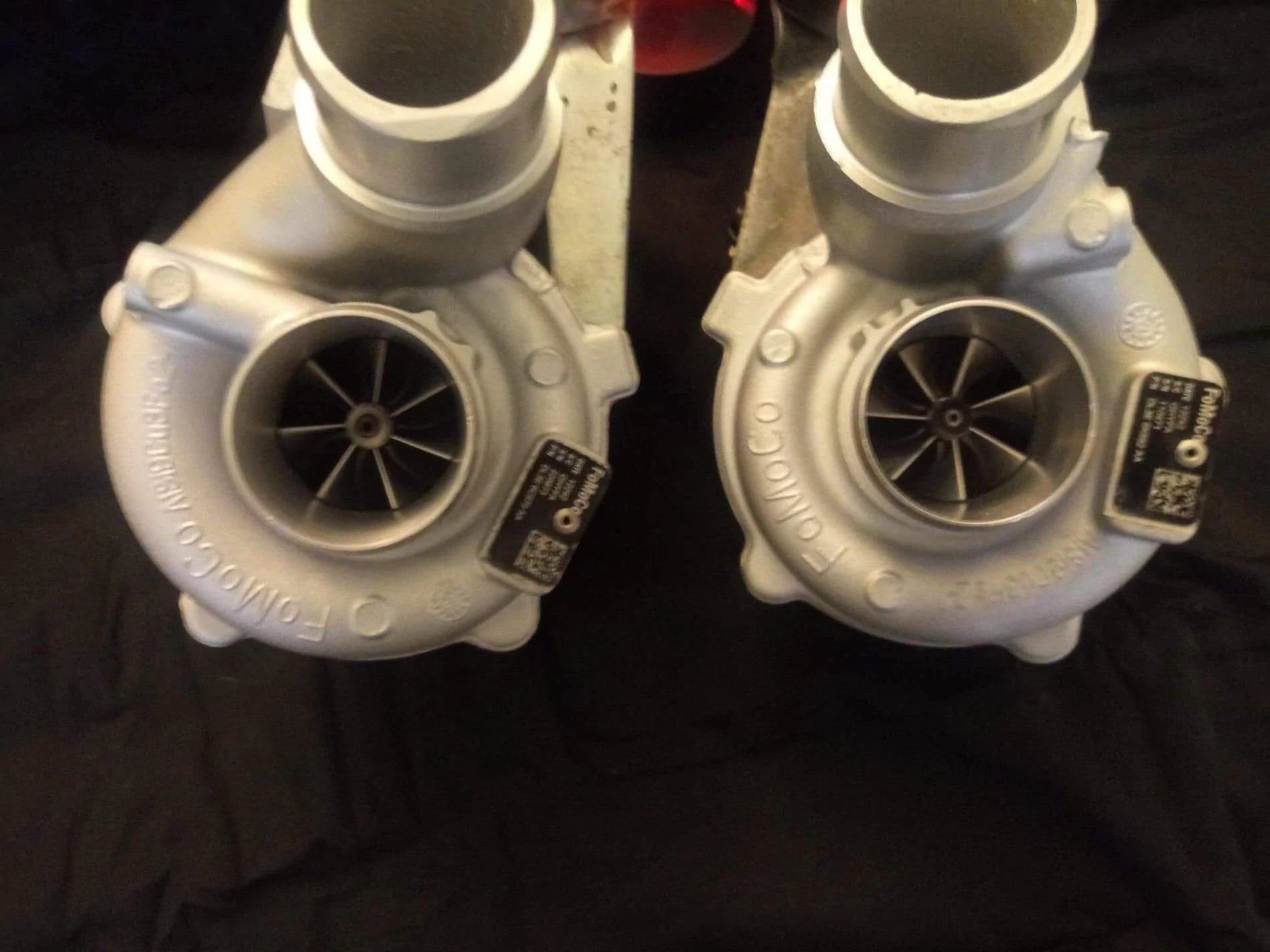

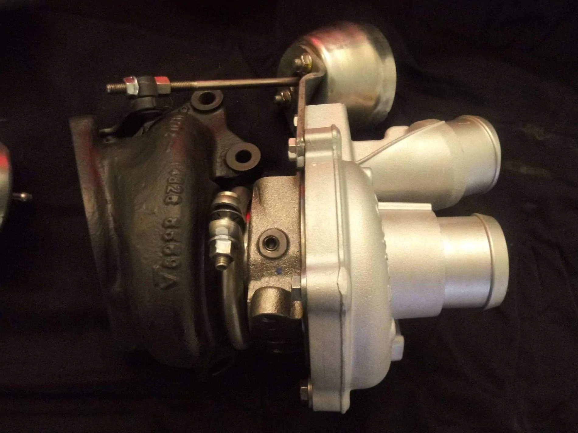

A little update on the custom F150 turbochargers. I highly recommend hitting Matt up at Turbobay if you need either stock rebuild, his regular rebuild with improved internals and a billet compressor wheel or the new biggest upgrade he worked on for me.
Sneak peak, almost twin turbo time. My custom 2013 F150 3.5 EB 59mm compressor turbochargers, custom turbine, custom HD internals along with front and rear step gapless rings.
Nice! Are you planning on running the factory wastegates?
