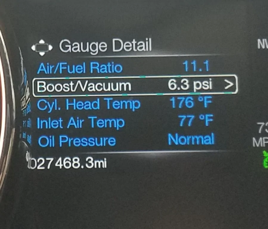

I'm getting over 6psi of boost with 3lb Springs and my controller set to the lowest possible setting. Starting to get the tune figured out. Next summer it'll be a beast. I pretty happy with my $45 used Audi A4 intercooler!

Love it man. You're doing it right. Over the winter you should send those turbos out to br upgraded, haha!
