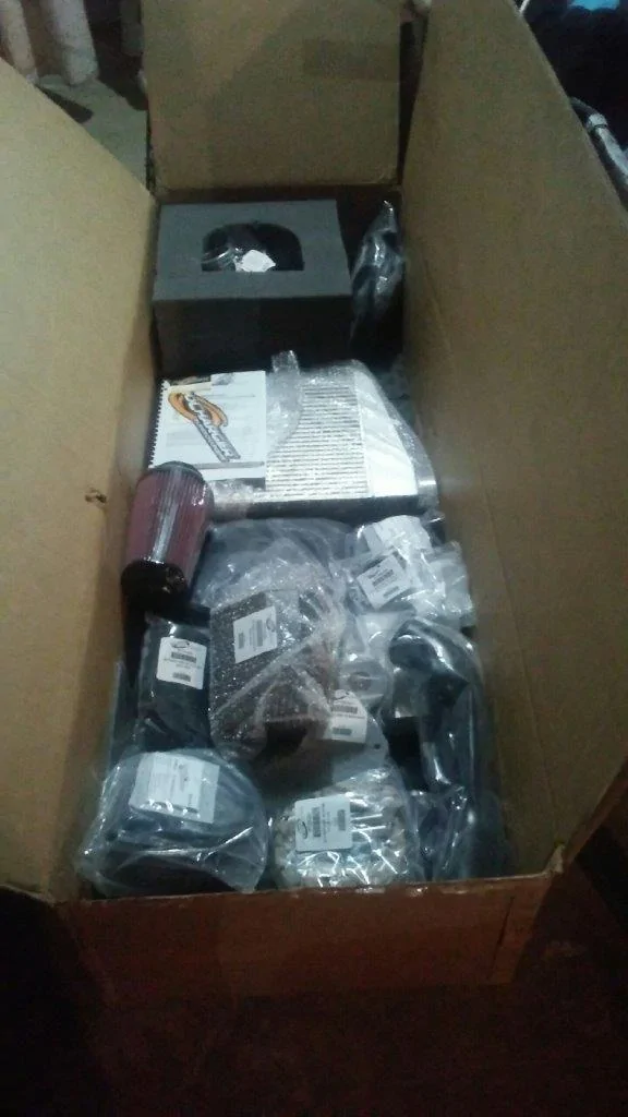

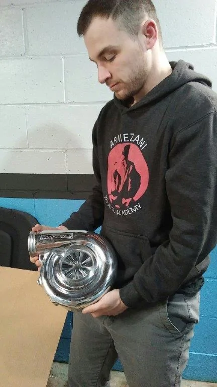

Got my Procharger! I Decided to go this route instead of twin turbo for the cost of TT started easily going over the amount this cost with the extra needed for it and I was not a fan of not seeing my power under the hood.
This is a D1 SC kit with a 10lb pulley, 90lb injectors.. vmp fuel pump booster... Shaftmasters 1 piece DS.... Brisk silver 1 step colder plugs.
I will be running 93 and e85 tunes from MPT.

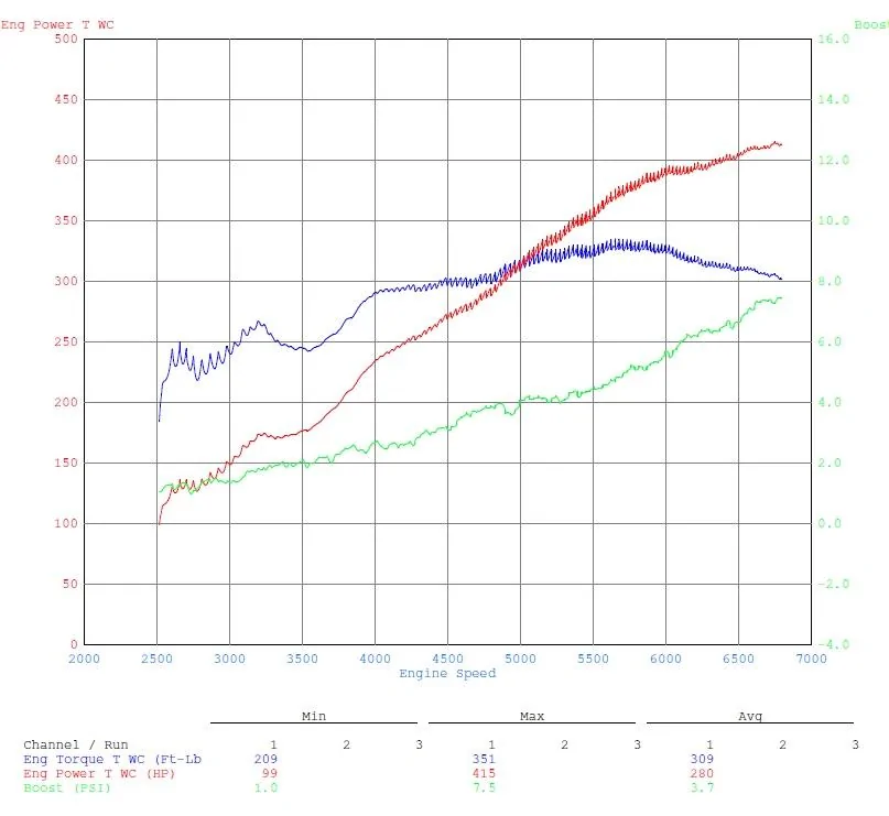

I really hope you make 550whp on only 10psi but IMO that isn't realistic. If there were E85 easily available here in Dallas I would go that route as well. I monitor knock and OAR religiously and even though my base tune is for 91 octane I still see a little knock at high boost on 93 octane winter gas.
Also, it isn't the clutch that goes it is the dual mass flywheel that breaks. If you take it easy on the shifts and don't bang through the gears the flywheel will probably last a little bit. Mine busted in less than a month.

I have the base 91 octane tune and did 415whp on a Mustang dyno (heartbreaker dyno) with a little less than 8 PSI (4.1 pulley). My guess would be less than 450whp on 10 PSI.
