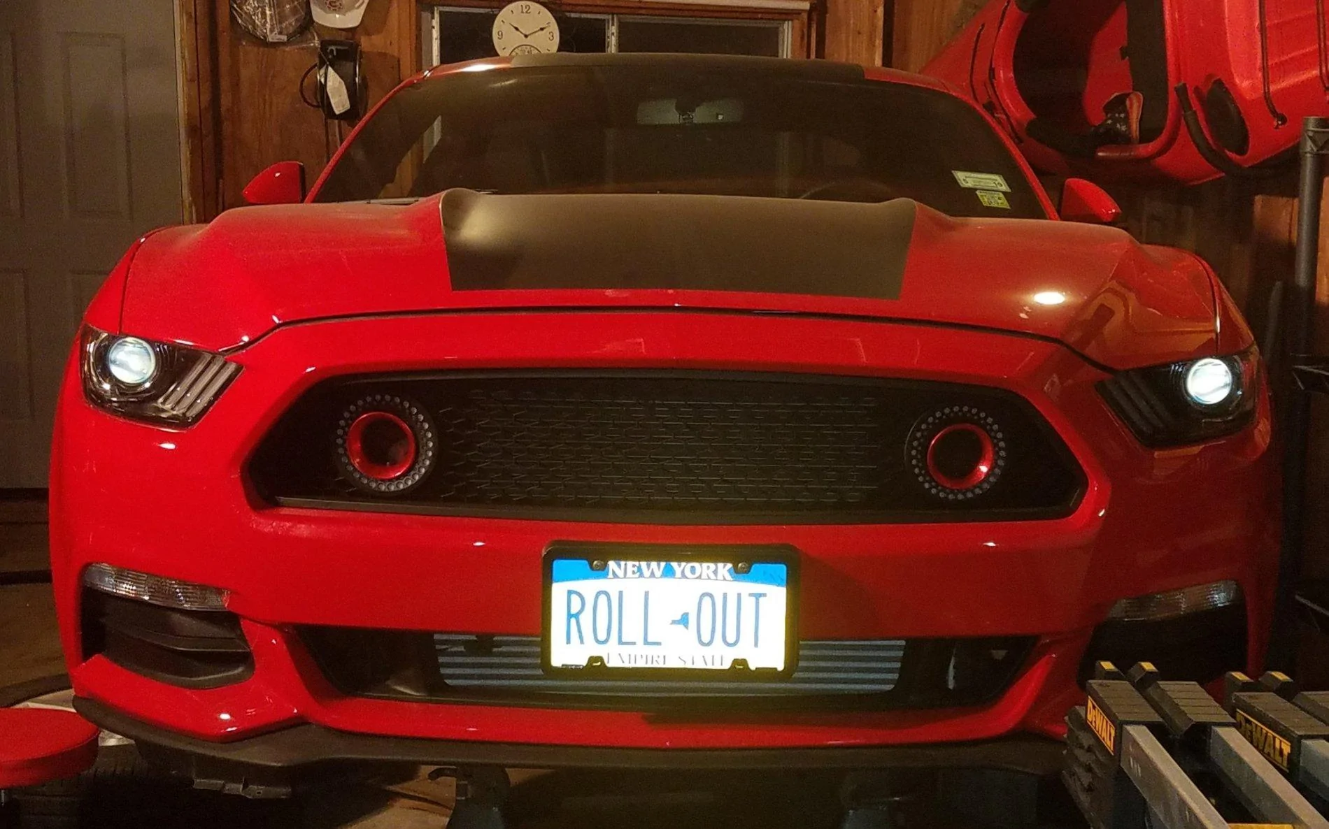

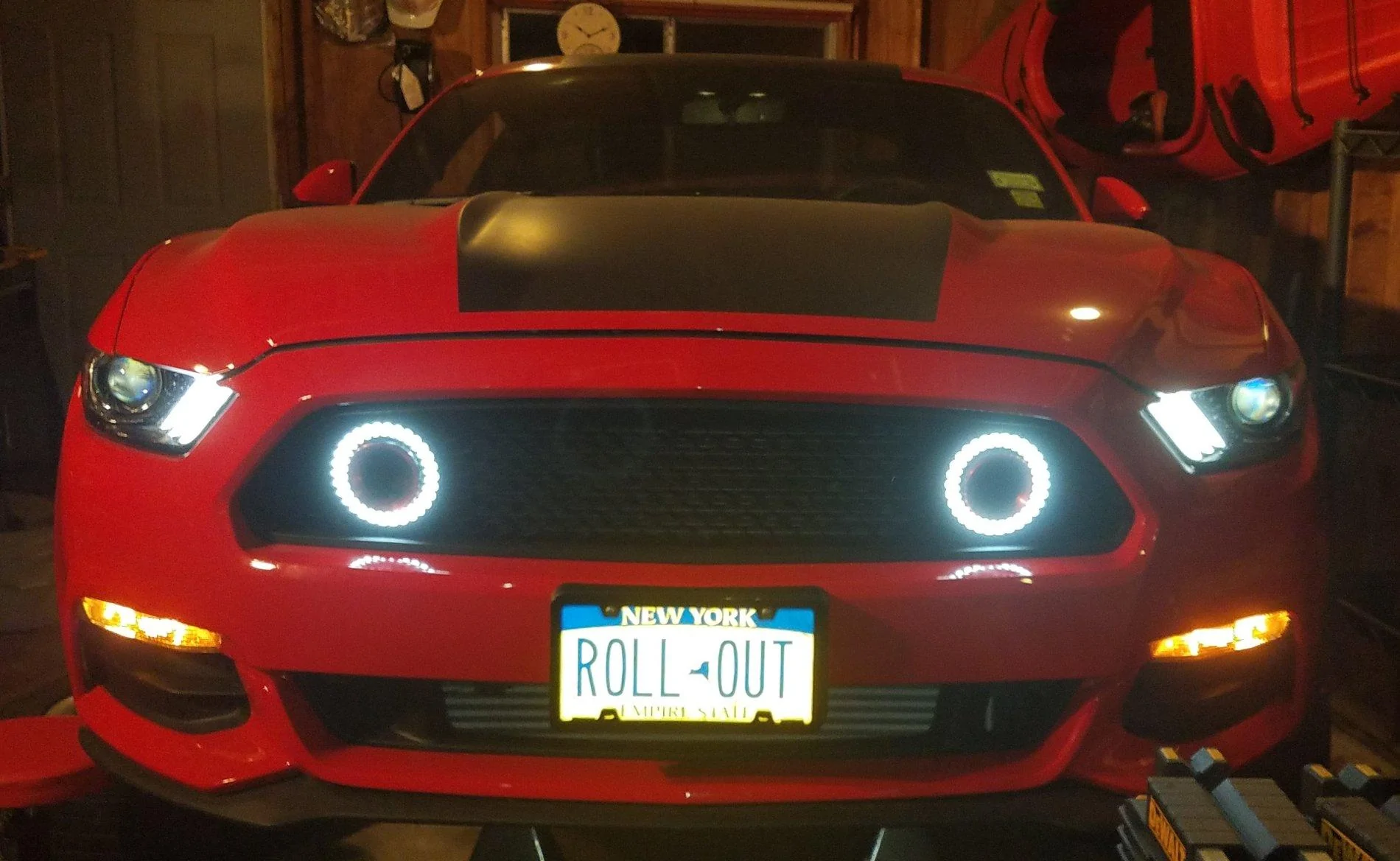

That looks great @Patrick! Does that one induction tube on the driver passenger side fit all the way? It looks like it slightly is off from the photo angle. Your concept looks like its all coming together! Nice that you found out about the MAP sensor. Rich source for the community.

The area around the openings in the grille are not perfect circles and also curve with the front of grille so there are small gaps around parts of the velocity stacks I used. They are both pushed as tight to the grille as possible. The angle of the picture probably exaggerates the one side more than the other.

I see. I honestly thought you were gonna leave the perforated screens in place or cut them out and replace woth with a better mesh then mount the filters behind them. I like your execution though. Unique.
I was going to leave them in, but I thought they might be too restrictive. The actual filters are in the engine bay so I can get to them without taking the bumper off.

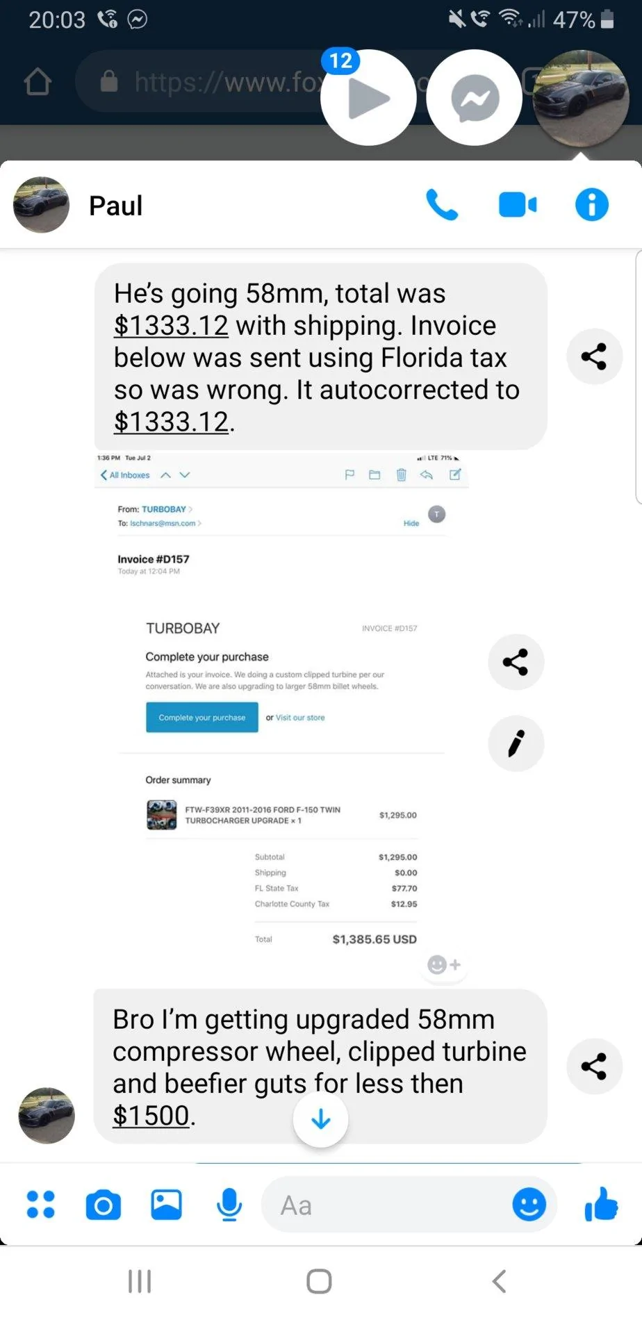

Well even better news for those chasing down the ecoboost conversion. As I mentioned before P3 found a guy who does the stock turbo upgrades on EcoBoost twin turbos and he has a knockout price. From everything he is going to do these will put the stock set above the Borg Warner GTs for half the price.
This means you can purchase a stock set of 2013-14 f150 ecoboost twin turbos and them upgraded to get better performing turbos for under the cost it would take you to get the BW GT drop in turbos. That's crazy...
I am following P3 regularly and we communicate about his project. If this turns into a high performing twin turbo project it will eliminate all the negatives/concerns associated with the ecoboost conversion. This could be gold.
*EDIT: This pricing is the prototyping of the 58mm build. There would be a jump in price from the standard 53mm upgrade, which hovers around the above pricing, but this shop's web pricing is still low as hell.
