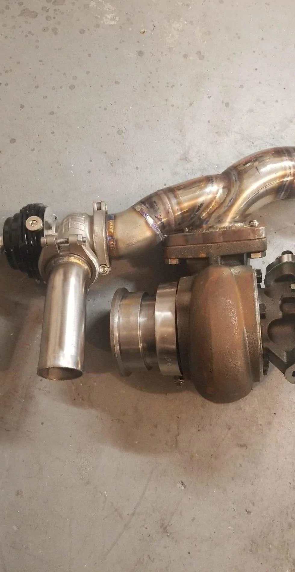

So figured I would update everyone here... Turbo project is still going, but very slowly. Current plan has been revised some from the rear mount setup to mounting them in place of the OEM cats. Idea is to take shorty headers (have a set ready to go), cut the ball end off and adapt it to the turbo flange. This placment should hopefully have the best of both worlds between the rear mount and OEM locations.

Just how far back is the "proper" rear mount setup? Is it in place of the mufflers? I think JMP's twin kit is similar to what you're planning now. If you haven't seen the photos from the kit installed on the S550 already let us know. If Sean doesn't beat me to it, I'll try to grab them when I get home tonight.
That's actually where the idea came from!
Rear mount to me is in place of mufflers. Moving the small turbos further back from the cylinder head should help reduce some of the issues associated with small turbos.
