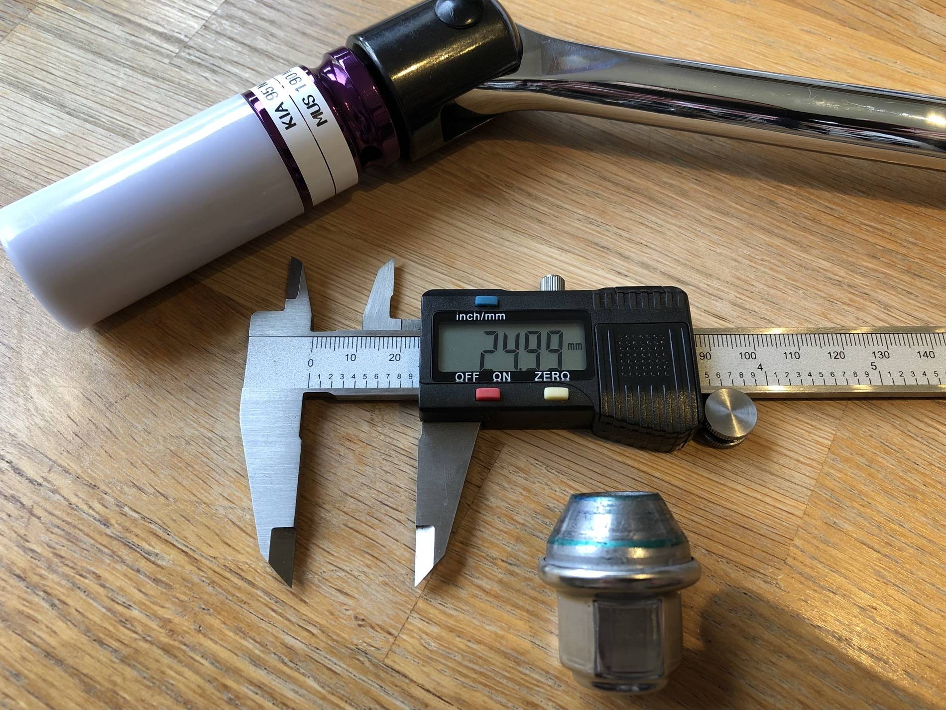

I'm not sure I believe that the lug nut in the picture of post #12 only contacts to where he has the arrow pointing.
I added dry wipe marker to mine then assembled / disassembled and photoed / measured the largest contact diameter :
That's based on a PP1 rear wheel :like: (post #12 was also a PP1 wheel)
WD :like:

On the Gorilla nuts I just bought the diameter at the widest point is .87". Your measurement of 25mm is .98" (almost exactly what I got when I measured my wear pattern on the original Ford lug-nuts). To me, that is a big enough difference to not use the smaller nuts, that's approximately 11% less contact area which may not sound like a lot but like you said, "almost fits is not acceptable."
