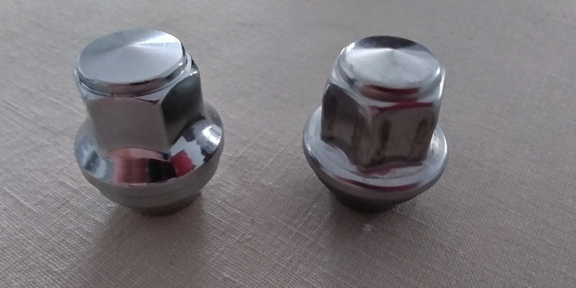

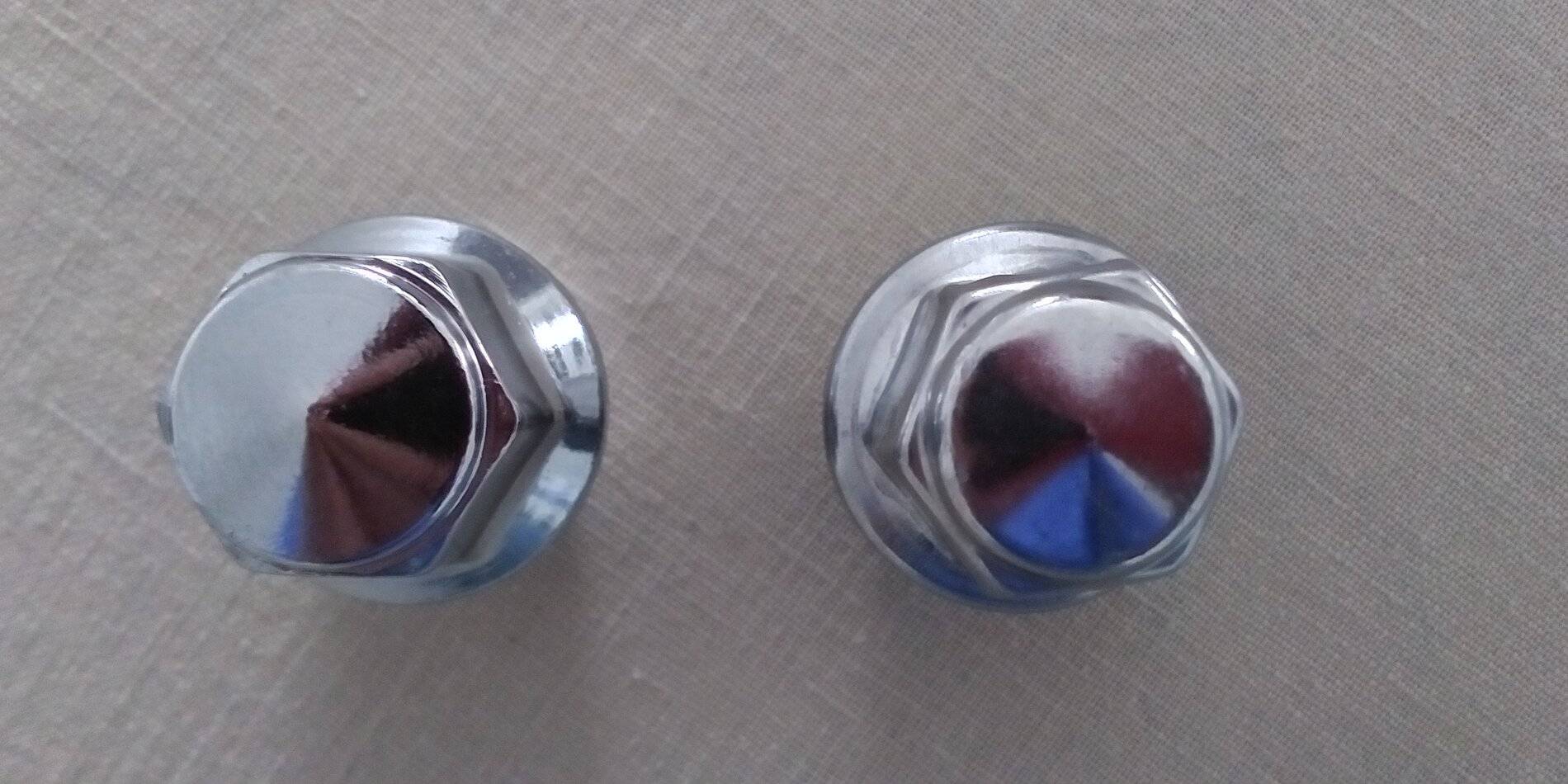

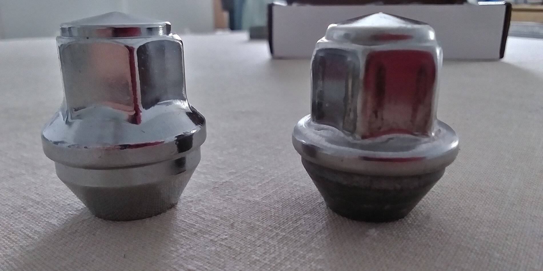

2015 Ecoboost Premium
So I received the new lugs. They're pretty nice. They have an identical appearance to the OEM lugs except where the nut meets the cone. But the best part is that they fit the @#$% lug wrench. They claim to be double chrome plated so they should hold up. Time will tell.
