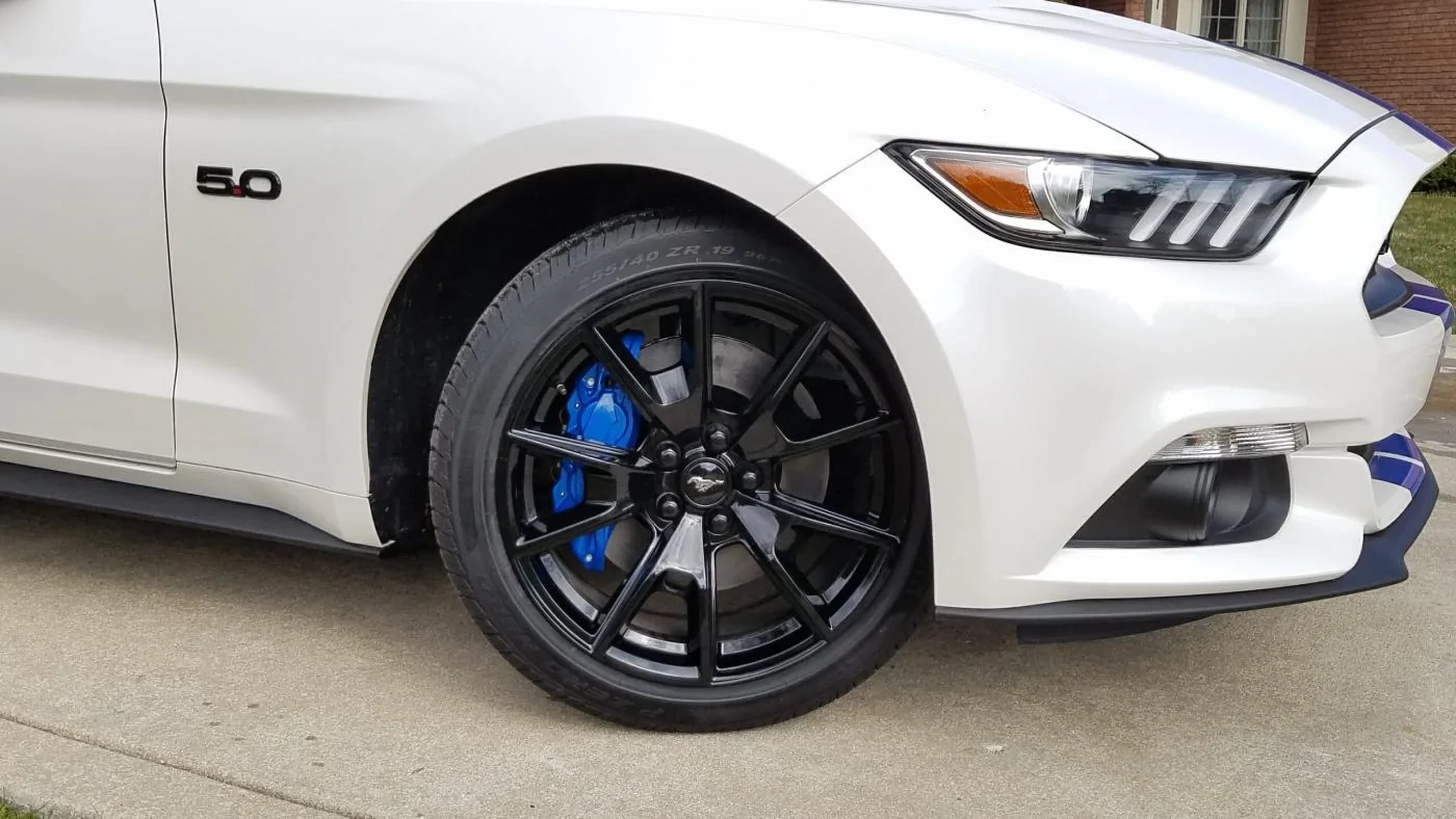

I'd go with Gorilla (like in my pic).
they matched very well with the black wheel.
No sense in paying more for essentially the same thing.
