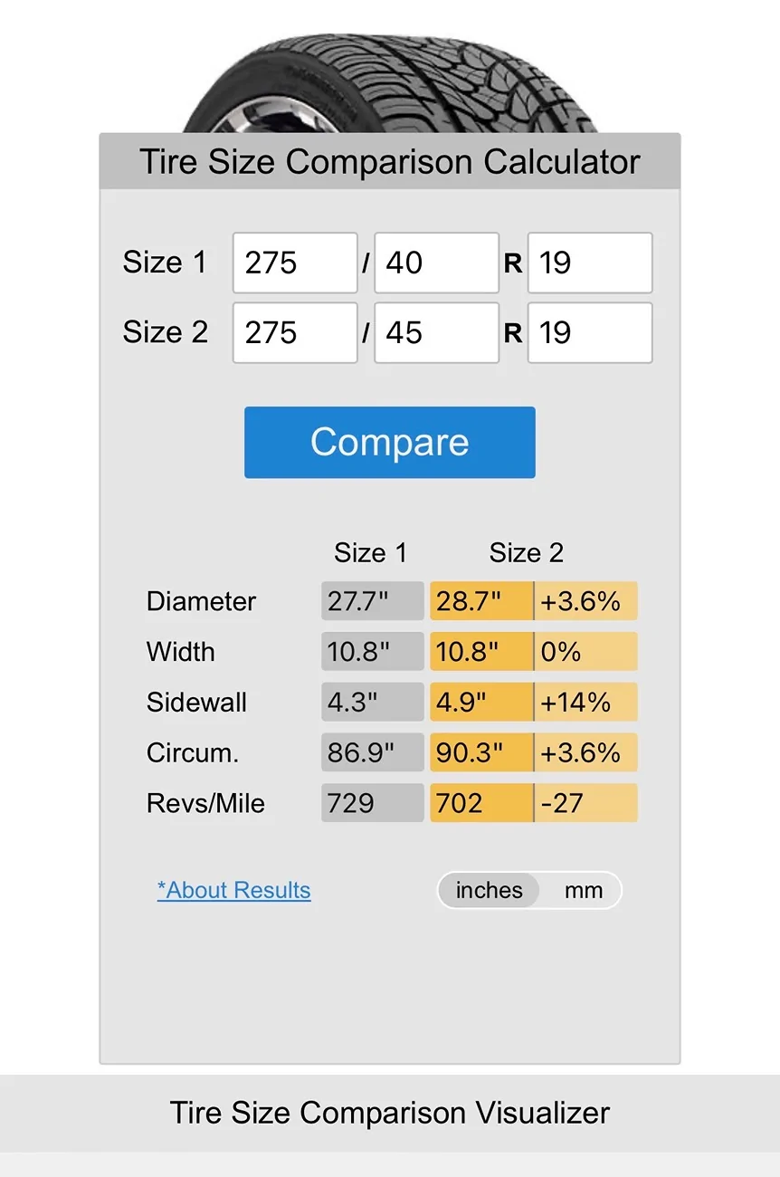

also 28.7" tall

Its an inch taller, so your rake will be 0.5” more extreme and I think thats going to me more distracting than any additional 0.5” of tuck. That much tire and rake will look like a drag car.
what does raising the rear do? I think raising the rear cg will make the car oversteer more entering corners and the rear will be more squirmy in general when cornering due to the taller sidewall the rear will feel less precise. Not entirely certain about the effects of rake because most people tune car car ride height with springnot tire diameter.
it probably doesnt handle great with the spring drop on the front axle anyway.
how crazy is the idea? Well its probably not the craziest, but it wont help the cornering. The car wont likely explode, but to be honest I dont know what tire diameter you can run before start to have firment issues in the rear. Someone else may know.

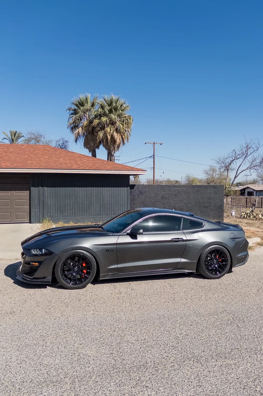

What is it exactly you're trying to get even? Second pic looks pretty even to me.
I think that the increased diameter is only 0.54 inches. (5% of 275mm). I don't think that this much of an increase will affect handling much at all - maybe increase understeer a bit in corners which could be adjusted out. I actually think that it would look good on this car.
While certain tires may vary, the calculators say its a full inch diameter, that's +0.5" radius, so 0.5" lift under the axle and the tires goes up 0.5" into the fender.
Nope, it’s an inch
