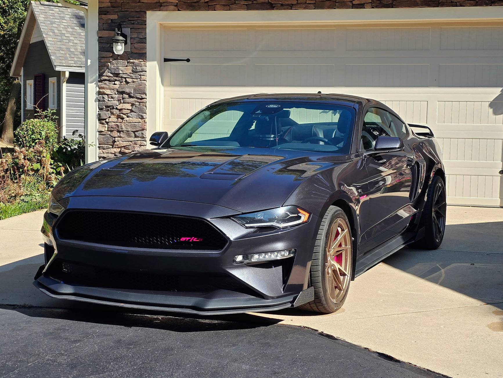

I'm running 19x9.5's square with 275/35's. The offset is +30 on mine. I'm on stock suspension, so the fender gap with the 35's is a bit much. A +35 offset will tuck them in a little more, which should help if you're lowered a bit, but i can't say for certain that they won't rub.

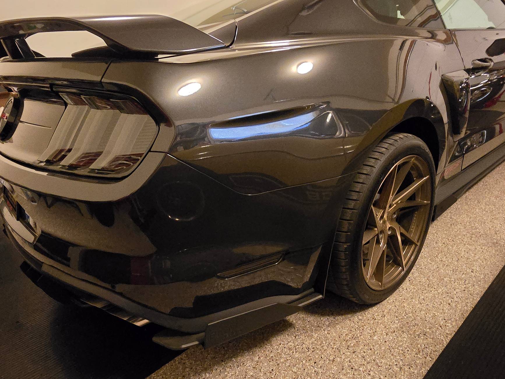

19x10 ET35 with 285/35R19 tires is an extremely common square wheel and tire setup.
A 275/35 on a 9.5” wheel with the same offset will be just fine, assuming you have normal camber.
