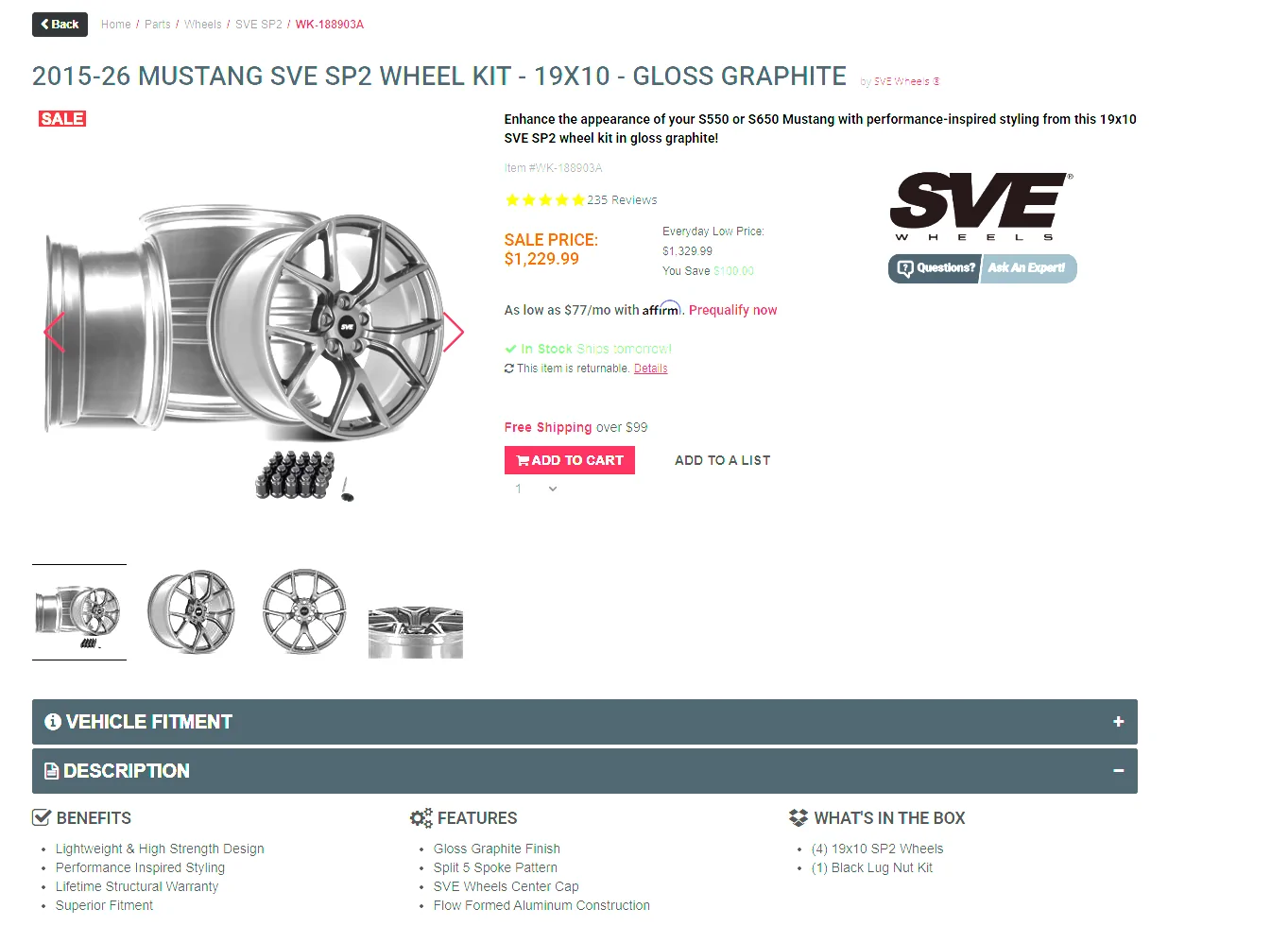

Yeah reports are they are 35lbs. SVE SP2 wheels are a 10” wide clone, almost 10 lbs lighter, and very affordable. I would (and did) go that route, but in 11” :)

This....better offsets and almost 10lbs. lighter. The Ford centercaps fit it as well.
SVE 19X10 PP2 wheel
SVE 19X10 PP2 wheel
