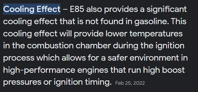

I read somewhere top mount is more reliable because of something to do with the oil not having to travel so far. Not sure how true that is. The cams were more for sound. What makes running on 93 a threat on reliability? Sorry for the questions.
Basically this.
Detonation is an issue as you increase power/boost. ECU can lower timing up to a point, but your are loosing power and it is just safer with higher than 93 octane rating. Plus if you get bad gas then will increase risk factors. And you live in Miami heat is a major issue!
