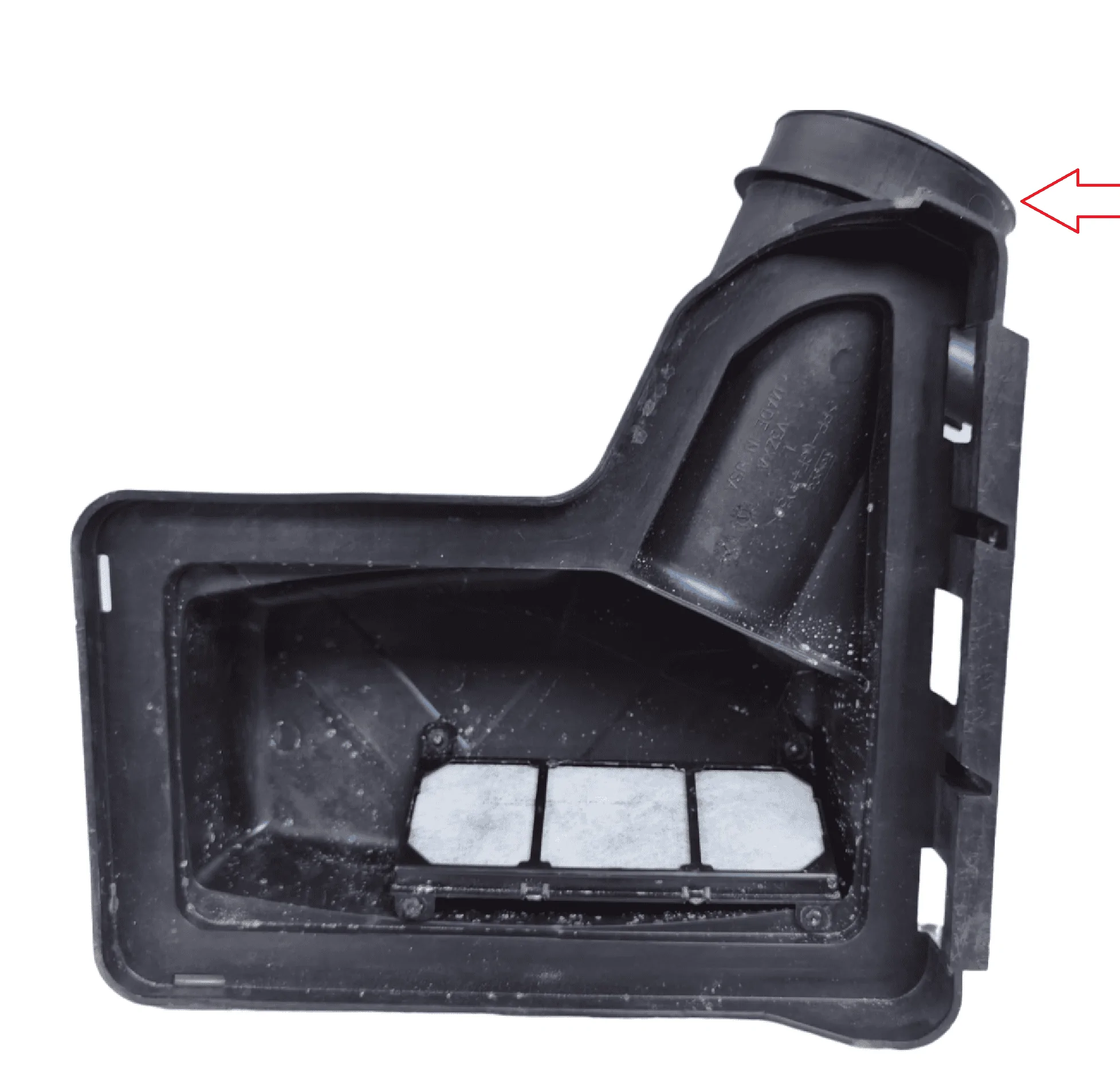

Did you take out the inner tube insert (from the MAF cross section) from the 22 and put it in the 2020 lid? I would think that would make the inner diameter the same (that is what I did).

See the below pic, that lip that the arrow is pointing at is the lip of the inner insert tube. You can wedge a flat head in that crack and work around the tube to pop out the insert.
NOTE: The pic is not from a 22 lid but I am just using it to show where the insert is on the 22 lid.
