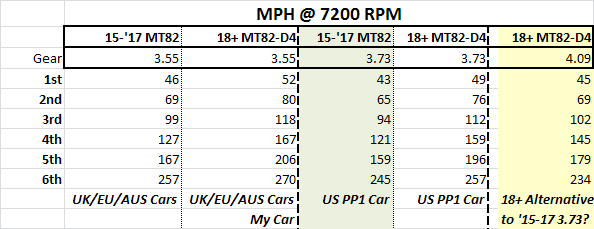

The 2018+ gearing truly kills the car. The 15-17 is quicker for sure up to about 100 mph due to much better gearing despite being down on power. I have a 4.09 and a Torsen ready to fit but will need to wait for the lockdown to end to have them installed. I can't wait because:
1. Drag racing the 3.55 and the revised manual transmission ratios on the 2018+ means you have terrible off the line performance;
2. When you shift you drop down too far in RPMs in the next gear;
3. When hustling on a back road the 3.55 and long gear ratios means you never leave 2nd gear and barely use 3rd, and I'd prefer more interaction below 100mph.
See a comparison of the gearing:

The 2018+ hearing truly kills the car. The 15-17 is quicker for sure up to about 100 mph due to much better gearing despite being down on power. I have a 4.09 and a Torsen ready to fit but will need to wait for the lockdown to end to have them installed. I can't wait because:
2. When you shift you drop down to far in RPMs in the next gear;

I don't see how the 3.73 is a better option if you have a 2018+ Mustang. 4th, 5th and 6th are basically different shades of overdrive gears when you look at the speed chart in my previous post. So, for around town driving I wouldn't expect any drawbacks as you have 6 gears to play with, and on the motorway you likely won't see any real decrease in mpg given the RPM gain is so modest, like 300-400 RPM.
1st gear in a 2018+ with 4.09 will be almost exactly the same as a PP1 2015-17 Mustang GT with the 3.73, so it's still a usable gear.
I say don't fear the gear, and if it was possible, I would have tried 4.3 or maybe even 4.56.
