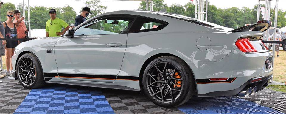

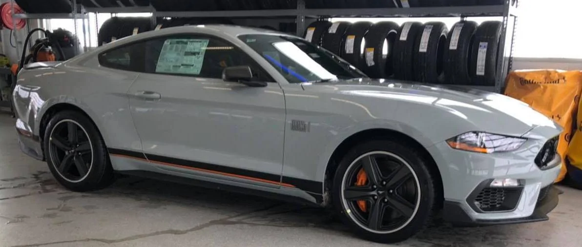

Look at the tyre to guard gap on the non HP car below with with standard 27 inch front and 27.7 inch rear tyre diameters.
Now look at the the tyre to guard gap on the HP model below, with 26.2 front and 26.4 rear tyre diameter. The wheel to guard gap has closed yet the wheel diameter has shrunk by nearly an inch on the front wheel and over an inch on the back wheel.
The gap to guard should have increased on the HP version and that is clearly not the case and its not just this photo its a similar story with other pics of the HP model.
I hope I'm wrong and there is only once set of springs for both models, but I'm certainly not convinced.

Tshenberg
Jan 4, 2021
419
736
Independence KY
Thomas
2021 Mach 1 Chassis M1908
Isn't it possible the top photo still has the shipping blocks in? If you watch Stangmode's latest video, he freakin drove home with them still on the car....

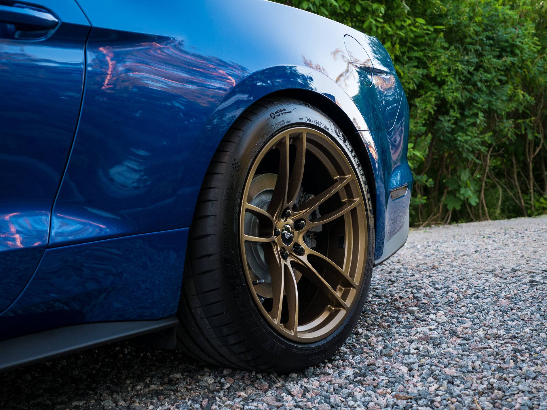

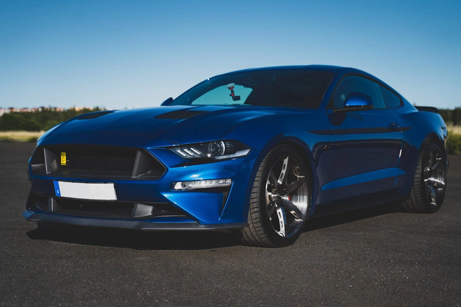

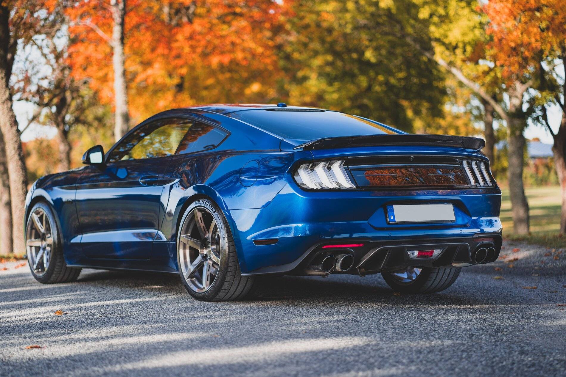

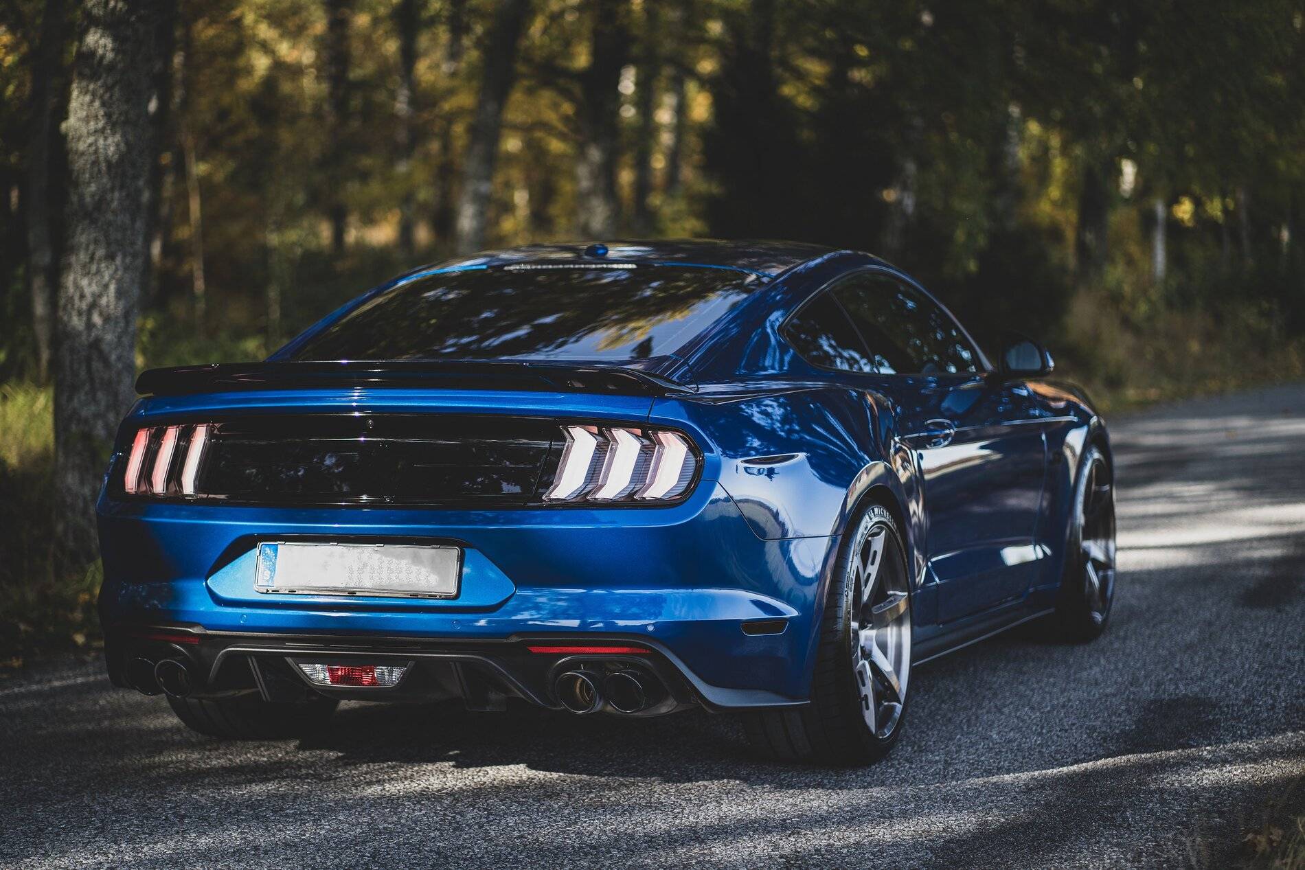

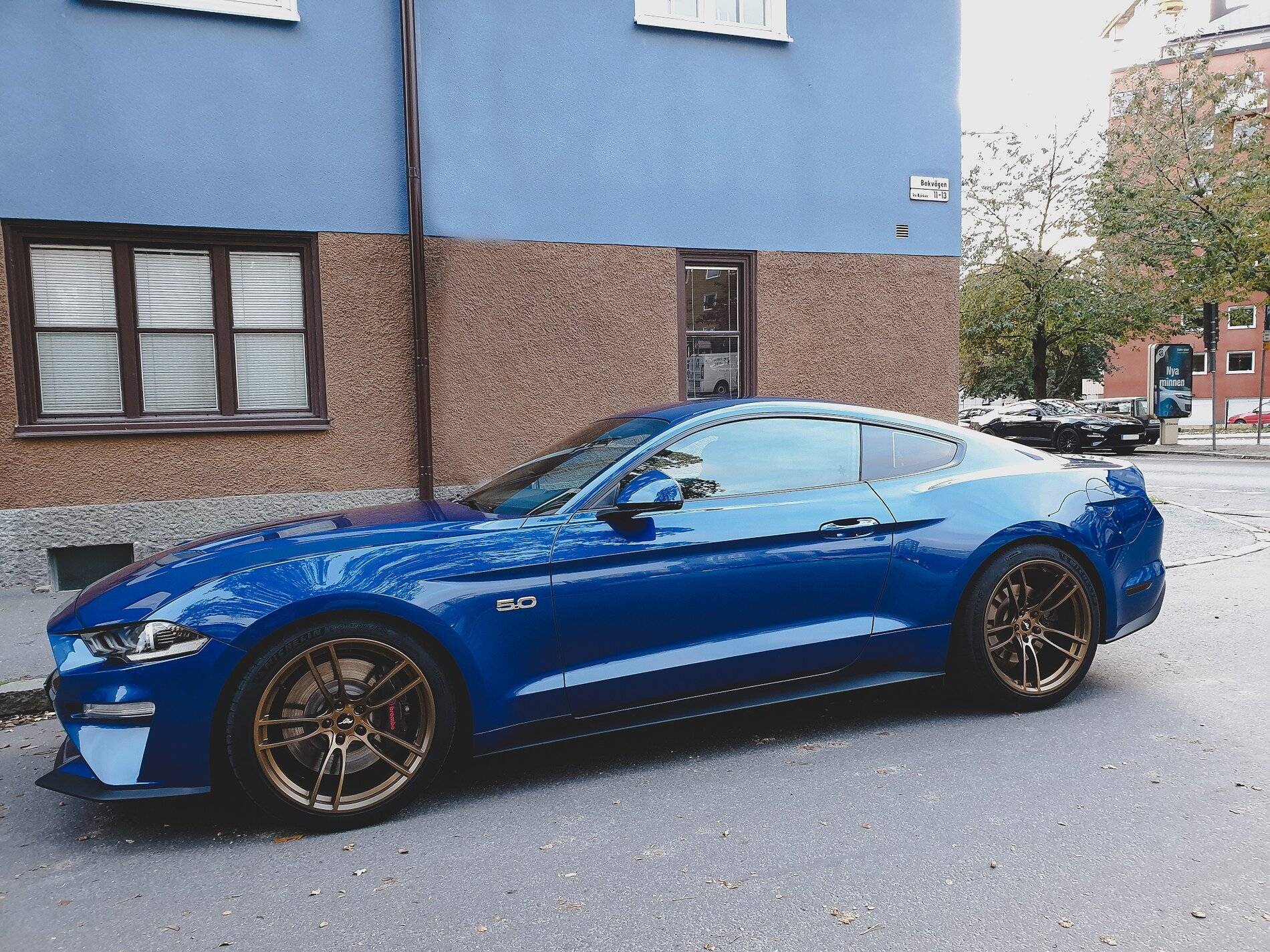

The effect from what lens, what angle the photos are taken makes a difference and can trick the eye. Also having a wider wheel and tire(and lower ET) fills up the void more which also can have a visual effect on the car is looking lower.
Tried to find some examples from my old car, both setups are with 20*10(ET35)+20*1(ET50). Only difference are the tires! In my opinion the car seems to be sitting at different heigts! Also to note if any of the pic would have been with a wide angle lens the "effect" would have been more pronounced
305/30
295/35

Yeah, pretty sure they'll have the same springs.............and the car in your photo still has the shipping blocks installed.

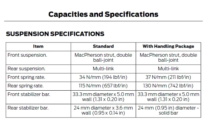

Going through the Mach 1 Supplement to Owner's manual, page 58, it looks like the springs are not the same.
https://www.fordservicecontent.com/...h-1-Supplement-version-1_su_EN-US_11_2020.pdf
thanks for that! Interesting man, I hate that we don't get the Mach 1 HP here.
I think this and the fact that we only get 3:55 Trac-loc was the nail in the coffin for me!
Interesting that hey are using the same bars more or less for both setups but different springs. Not sure if they have gone with a solid one for the HP to take the stress better due to e.g tires that have much more grip.
I don't want to bother with replacing the springs as well....
