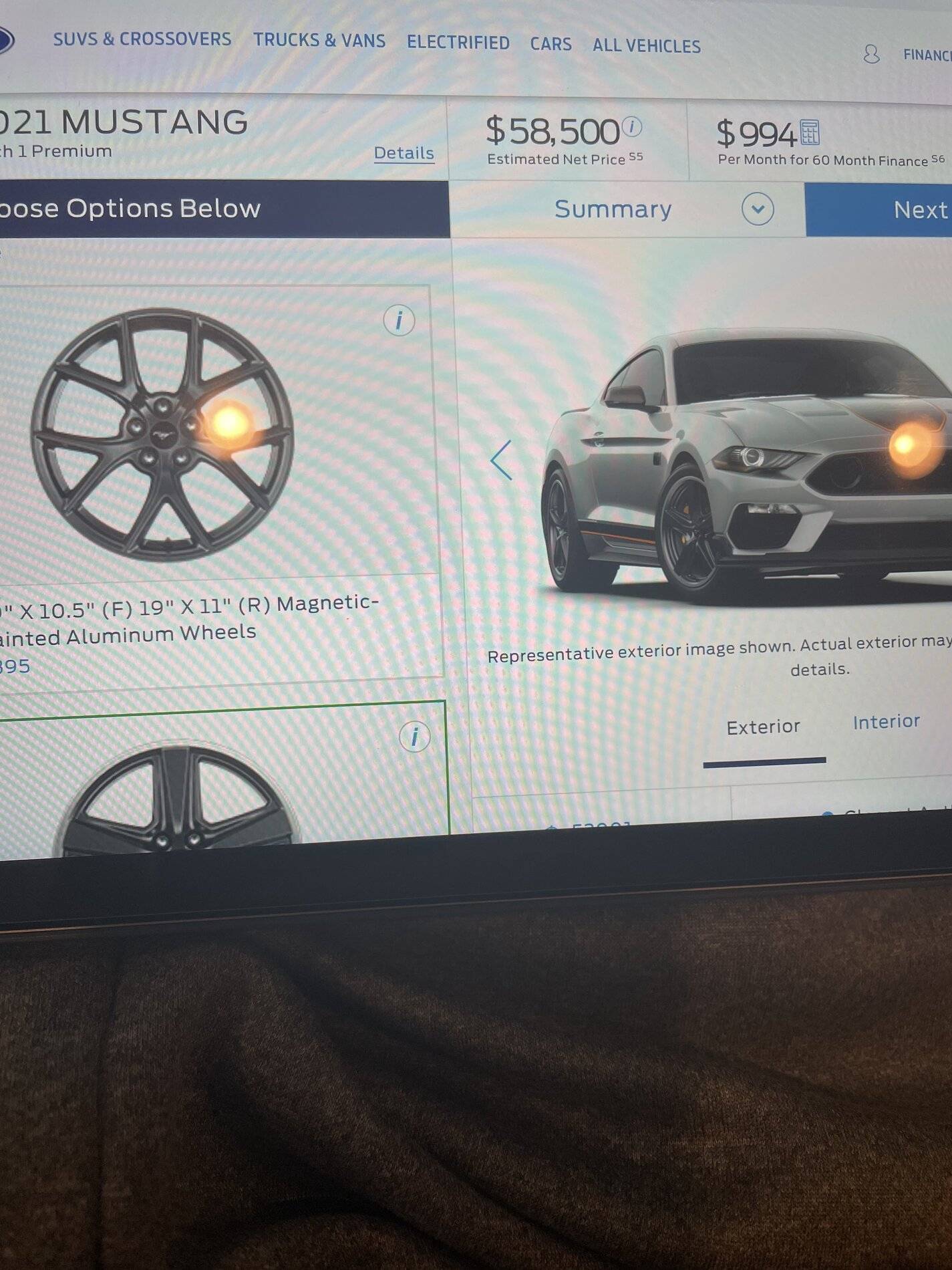

As of right now those rims are unavailable. They where up on the Ford build site when I built and purchased my 2021 Mach 1. The posted pic is on the Ford build site now, and what came on my Mach 1.

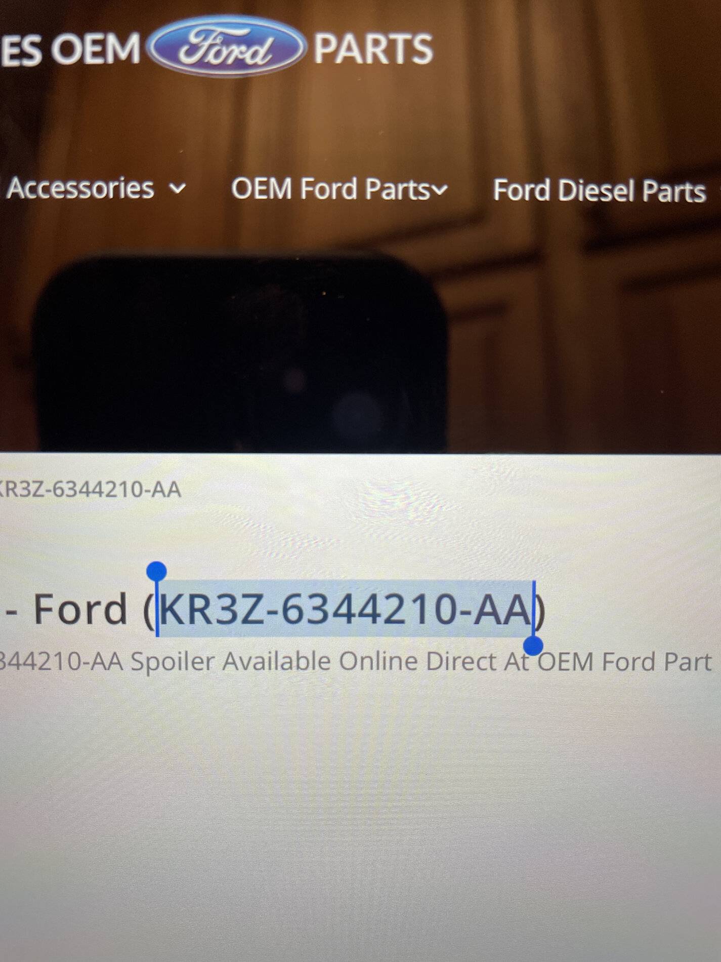

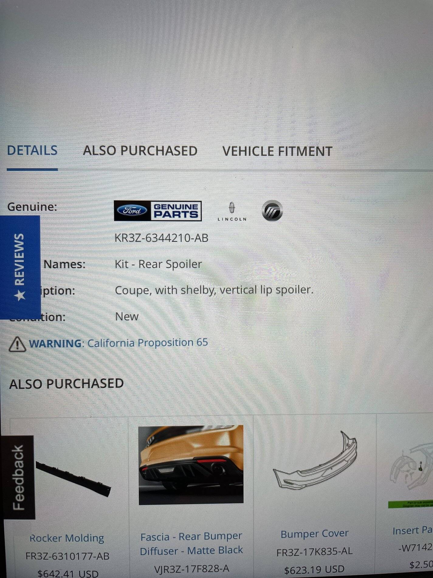

I ordered the front splitter and rear wing and gurney flap at Ford when picking my car up. First PN ending in AB is gurney flap. Second ending in AA is the spoiler. I’ll post the splitter PN shortly.
