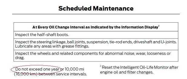

an oil change is required every year minimum. Most don't hit the miles side of the equation.
Even if you don't drive it? Here its cold 6 month of the year. I changed the oil in the fall and spring time it told me to change the oil. Didn't put 1k on the oil.
even if you don't drive it. Im not saying the oil is bad, what I am saying is that your oil life monitor will tell you to do it in one year or whenever it calculates the oil life based upon the kind of driving you do.
I had some oil tested that sat for a long time. There was nothing wrong with it.
