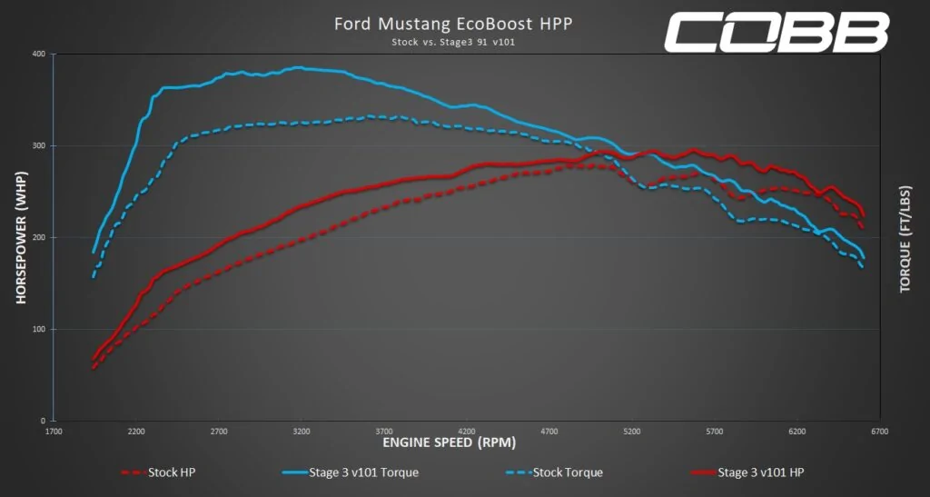

91 Octane
The 91 Octane version of the Stage 3 map requires 91 octane (95 RON) or better. For power gains, Maximum gains are measured as the largest gain at any single RPM (point on x-axis) between the two plots. Peak gains refer to the difference between the two highest points anywhere along the full RPM range.
Hardware Requirements
Power Gains
  • Peak Gains +15.15% TQ / 7.15% WHP
  • Max Gains +25.37% TQ / 25.37% WHP
Boost Level
  • Up to ~24.5psi tapering to ~19.5psi by redline. (+/- 2psi).

Interesting graphs. Curious if you have any insight as to why the HP taper near redline that the FoRS doesn't have when tuned?
Also not that we needed any more proof, but man this engine just needs octane.

A combination of turbo differences, along with cam and manifold differences, will allow the turbo in the RS to hold higher boost levels to redline and still stay within the turbo's efficiency range.
All of the EcoBoosts are definitely sensitive to octane!

2 digits after the decimal point? That's quite a sensitive dyno, lol.
